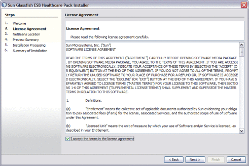

The License Agreement window appears.
Accept the License Agreement and then click Next.

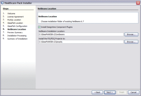

The NetBeans Location window appears.
When installing on Mac OS, the path to select is GlassFishESB_Home/netbeans.app/Contents/Resources/netbeans.
Accept or modify the default values, and then click Next.

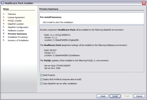

The Preview Summary window appears.
Click Install.
Unless you deselect the options at the bottom of the page, the PIX/PDQ projects will all be built and deployed following installation. By default, the GlassFish server is shut down after the installation is complete. If you select Stop GlassFish Server After Installation, be sure to restart the server when the installation is done.

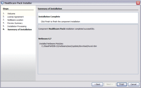

When the installation is complete, click Finish.

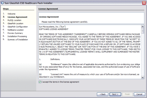

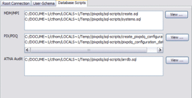

To view the database scripts that will be run to create the required databases, do the following:
Click the Database Scripts tab.
Select a script from any of the three boxes, and then click View next to that box.
The script appears in read-only view.
The MDM/MPI scripts create the core master index tables. The PIX/PDQ scripts create tables specific to the PIX/PDQ solution. The ATNA Audit scripts create the Audit database.

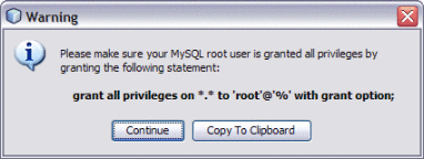

A warning dialog appears to verify that your MySQL root user has the required privileges.
Do one of the following:

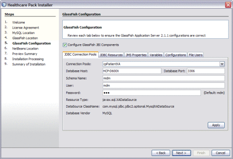

On the GlassFish Configuration window, deselect Configure GlassFish JBI Components if you do not want the runtime components to be automatically created by the installer. Otherwise, complete the following steps.

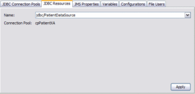

To configure the automatically created connection pools, do the following:
This step is optional. If you accepted the default values on the MySQL Location window, you should skip this step. Only change the values on this page if you modified the MySQL information or if you are using a different database.
Click the JDBC Connections Pools tab.
Select any of the predefined connection pools to customize the pool.
Modify any of the open fields.
For more information on the predefined connection pools and the fields on this tab, see JDBC Connection Pool Fields.
Click Apply.
Repeat the above steps to configure a different connection pool.
To view the automatically created JDBC resources, click the JDBC Resources tab.
These correspond to the predefined connection pools above and cannot be modified.

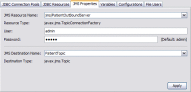

To configure the username and password for the Master Index outbound topic, do the following:

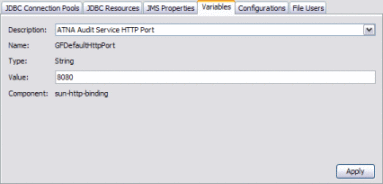

To modify the values for the predefined application variables, do the following:
Click the Variables tab.
In the Description field, select the variable to modify.
For more information about the predefined variables, see Predefined Application Variables.
Modify the Value field and click Apply.
Repeat the above steps for each variable to modify.

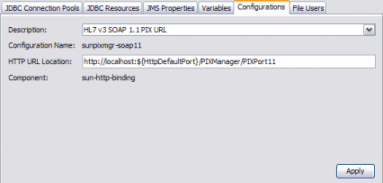

To modify the values for the predefined application configurations, do the following:
Click the Configurations tab.
In the Description field, select the configuration to modify.
For more information about the predefined configurations, see Predefined Application Configurations.
Repeat the above steps for each configuration to modify.

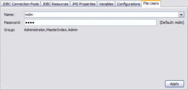

To modify the passwords for the data management and monitoring tools, do the following:

This step ensures that the Healthcare Pack is installed to the correct instance of NetBeans.
Complete the steps under To Configure Runtime Components.
On the NetBeans Location window, deselect Install JBI Runtime Component if you do not want to install the GlassFish components. Otherwise, perform the following steps.
Accept or modify the location for the NetBeans home directory.
Accept or modify the location where the PIX/PDQ projects will be installed.
Click Next.

On the Preview Summary review your installation selections. If you have any changes, use the Back button to navigate back through the wizard.
If you want the PIX/PDQ projects to be automatically built following installation, select Build Projects.
If you want the PIX/PDQ projects to be automatically built and deployed following installation, select both Build Projects and Deploy Built Artifacts.
If you do not want the installer to stop the GlassFish server after installation, deselect Stop GlassFish Server After Installation.
If you deselect this option, be sure to restart the server once installation is complete.
Click Install.
When the installation is complete, the Summary of Installation window appears, and displays a message letting you know whether or not the installation was successful.
The following topics describe fields on the GlassFish Configuration window of the Installer:
The fields on the JDBC Connection Pool tab of the GlassFish Configuration window configure the connection pools that are automatically created by the installer. If you configured the installer to automatically create the Healthcare Pack databases, the information you specify in the JDBC Connection Pool fields should match the information you specified in To Configure MySQL. If you did not change the fields for the MySQL database, you can accept the default values on this page. If you are not using the installer to create the database and are using a different database instead, the field values on this page should match the information for the database you are using.
The following table lists and describes the application variables that are predefined for the PIX/PDQ system. The port numbers and variables are based on the default GlassFish ESB port numbers. If you customized your port numbers, you need to modify the corresponding variable values.
Variable Name |
Variable Description |
Variable Value |
GFDefaultHttpPort |
ATNA Audit Service HTTP Port |
The port number your domain is listening on for HTTP requests. The default value is 8080. |
jmsURL |
PIX Update Notification JMS URL |
The URL to the Java MQ server you are using. The default value is mq://localhost:7676. |
sunpixmgr-v2–url |
HL7 v2 Listening URL |
The URL used to connect to the HL7 v2 external system. The default value is hl7://localhost:3600 |
sunpixmgr-application |
PIX Update Sender HL7 v2 Application |
The HL7 v2 sending application. The default value is SUGA. |
sunpixmgr-facility |
PIX Update Sender HL7 v2 Facility |
The HL7 v2 sending facility. This value further identifies the sending application. The default value is SUNVAN. |
sunpixmgr-device |
PIX Update Sender Hl7 v3 Device |
The HL7 v3 sending device. The default value is 2.1.12^654. |
sunpixmgr-organization |
PIX Update Sender HL7 v3 Organization |
The HL7 v3 sending organization. There is no default value since this is not a required property for HL7 v3. |
The following table lists and describes the application configurations that are predefined for the PIX/PDQ system. The application configurations are only used with the HL7 v3 projects. If you are using HL7 v2, you do not need to modify these values.
Configuration Name |
Configuration Description |
Configuration Value |
sunpixmgr-soap11 |
HL7 v3 SOAP 1.1 PIX URL |
The default value is http://localhost:${HttpDefaultPort}/ PIXManager/PIXPort11. |
sunpdqsup-soap11 |
HL7 v3 SOAP 1.1 PDQ URL |
The default value is http://localhost:${HttpDefaultPort}/ PDQSupplier/PDQPort11. |
sunpixmgr-soap12 |
HL7 v3 SOAP 1.2 PIX URL |
The default value is http://localhost:${HttpDefaultPort}/ PIXManager/PIXPort12. |
sunpdqsup-soap12 |
HL7 v3 SOAP 1.2 PDQ URL |
The default value is http://localhost:${HttpDefaultPort}/ PDQSupplier/PDQPort12. |
When installing on Mac OS, the path to select is GlassFishESB_Home/netbeans.app/Contents/Resources/netbeans. There are no GlassFish components to install for Master Index, so you do not need to provide the GlassFish server home directory for this installation.
Accept or modify the location for the NetBeans home directory, and then click Next.
Click Next.
