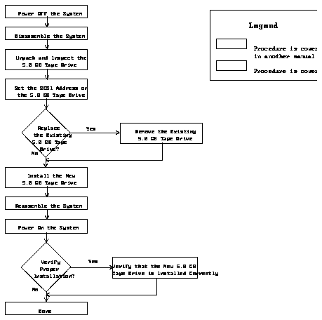

The installation or replacement of the tape drive consists of the procedures shown in Figure 1-1. These procedures are explained in greater detail in each system-specific chapter.
