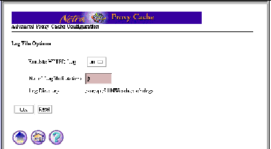

Log File Options
To View or Modify Log File Options
  1. Click Log File Options in the Advanced Proxy Cache Configuration page. The page shown in Figure 4-10 is displayed.
    Figure 4-10 Logs File Options
    Graphic
  2. Under the Logs File Options heading, enter or accept values for the following properties:
Emulate HTTPD Log
By default, the server emulates the log file format used by many HTTP servers. Accept the default of on or select off to turn this feature off.
No. of Logfile Rotations
Specifies the number of log file rotations the server performs upon receipt of a signal from an application such as the rotlog program. With the default of 10, the software creates log files with extensions from 0 through 9. Set this property to 0 to turn off log file rotation. See "Managing Proxy Cache Service Log Files" for a description of rotlog.
Log Directory
You do not have the option to change the default log-storage directory, /var/opt/SUNWcache/cachelogs, in the current release.

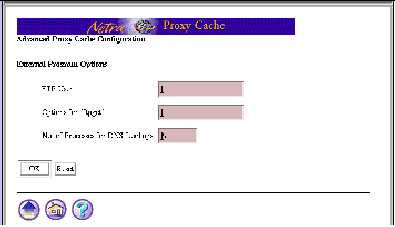

External Program Options
To View or Modify External Program Options
  1. Click External Program Options in the Advanced Proxy Cache Configuration page. The page shown in Figure 4-12 is displayed.
    Figure 4-12 External Program Options Page
    Graphic
  2. Under the External Program Options heading, enter or accept values for the following properties:
FTP User
The string supplied as the login password for anonymous ftp. This enables you to supply an informative address, if you want.
Options for `ftpget'
The arguments supplied to the ftpget command. The ftpget command retrieves FTP data for the cache. HTTP and Gopher protocol support are built into the proxy cache software. To view a list of valid ftpget arguments, invoke /opt/SUNWcache/lib/ftpget, with no arguments.
No. of Processes for DNS Lookups
Number of processes spawned by the Netra Proxy Cache Server to service DNS name lookups. This number indicates the maximum number of concurrent DNS lookups. On heavily loaded caches, you might want to increase the this value from a default of 5 to 10. The maximum is 32.
