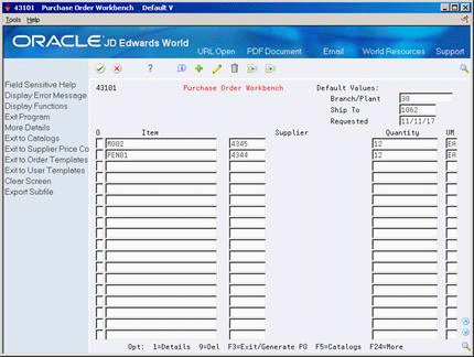

You can enter orders for multiple suppliers simultaneously, instead of having to enter a separate order for each supplier. You specify the items you want to purchase and the supplier from whom you want to purchase each item on the purchase order workbench.
After you enter the items, you must direct the system to create purchase orders. The system combines items for each supplier on a separate purchase order.
The Purchase Order Workbench (P43101) supports export functionality. See Work with Import/Export in the JD Edwards World Technical Tools Guide for more information.
Caution:
The Purchase Order Workbench does not process kit items. If you try to generate a purchase order for a kit item, the system displays an error message.
To enter orders for multiple suppliers
On Purchase Order Workbench
Figure 5-1 Purchase Order Workbench screen
Description of Figure 5-1 follows
Description of "Figure 5-1 Purchase Order Workbench screen"
  1. Complete the following fields:
    • Branch/Plant
    • Ship To
    • Requested
  2. Complete the following fields for each item that you want to order:
    • Item
    • Supplier
    • Quantity
    • UM (unit of measure)
  3. Choose More Details (F4) to display information in the detail area (Fold), as needed.
    Figure 5-2 Purchase Order Workbench (Detail) screen
    Description of Figure 5-2 follows
    Description of "Figure 5-2 Purchase Order Workbench (Detail) screen"
  4. Complete the following fields in the detail area for each item, as needed, and press Enter:
    • Account Number
    • Unit Cost
    • Extended Cost
    • Subledger
    • Ship To
    • Line Type
    • Requested
    • Effective

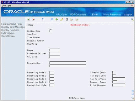

  5. Access Workbench Detail.
    Figure 5-3 Workbench Detail screen
    Description of Figure 5-3 follows
    Description of "Figure 5-3 Workbench Detail screen"
  6. On Workbench Detail, complete the following fields, if necessary, and press Enter:
    • Buyer
    • Promised Date
    • G/L Date
    • Description
    • Reporting Codes 1 - 5
    • Taxable (Y/N)
    • Tax Expl Code
    • Tax Rate/Area
    • Payment Terms
    • Print Message
  7. Exit to Purchase Order Workbench.
    You are now ready to create purchase orders for the detail lines you have entered. For information about this process, see Section 5.7, "Creating Orders from Existing Detail Lines."

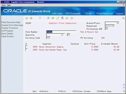

When you order an item, you must specify the supplier from whom you want to purchase the item. You can review all suppliers that provide a particular item and the price that each supplier charges for the item. Once you identify the supplier from whom you want to order the item, you can specify the quantity you want to order and return the information to the purchase order workbench.
To choose a supplier from whom to purchase an item
  1. Press F6 to access Supplier Price Comparisons.
    Figure 5-4 Supplier Price Comparison screen
    Description of Figure 5-4 follows
    Description of "Figure 5-4 Supplier Price Comparison screen"
  2. Complete the following field to locate all suppliers who provide a particular item:
    • Item Number
  3. To enter the quantity of the item you want to order, complete the following field:
    • Quantity

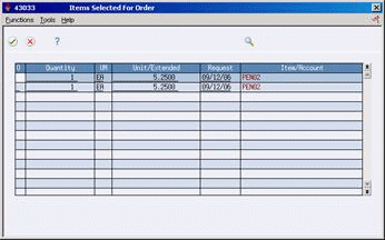

  4. Enter option 4 next to the supplier from whom you want to order the item, and press Enter.
  5. Press F3 to return to Purchase Order Workbench.
  6. On Purchase Order Workbench, review the new order detail line.

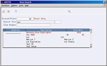

Before you order an item through Order Entry, you might want to review information about the item, such as:
  • The item number
  • The item description
  • The quantity available
  • The quantity on order
You can locate item information and choose items to order. You use processing option 21 in your version of Order Entry (P4311) to choose the type of item search you want to perform:
  • Basic item search
  • Detailed item search
  • Full item search
  • Supplier item selections by catalog
The type of search you choose determines the search window that appears when you press F1 on the Item Number field in Order Entry. Each window displays slightly different information and provides a unique method by which you can choose items to order.
5.4.1 Basic Item Search
You can review item numbers and descriptions using the basic item search, which allows you to choose one item to return to the detail line using option 4.
Figure 5-5 Item Search Window screen
Description of Figure 5-5 follows
Description of "Figure 5-5 Item Search Window screen"
5.4.2 Detailed Item Search
You can review item numbers, descriptions, and item availability using the detailed item search. You can choose multiple items to enter on order detail lines by indicating the quantity of each item you want to order.
Figure 5-6 Item Search (Detailed) screen
Description of Figure 5-6 follows
Description of "Figure 5-6 Item Search (Detailed) screen"
5.4.3 Full Item Search
You can review item numbers, descriptions, item availability, and on-hand quantities using the full item search. You can locate items based on a variety of criteria. The full item search lets you choose a single item and enter it on an order detail line using option 4.
Figure 5-7 Item Search (Full Item) screen
Description of Figure 5-7 follows
Description of "Figure 5-7 Item Search (Full Item) screen"
To enter items using item search
On Purchase Order Detail
  1. Press F1 in the following field:
    • Item Number
    The type of item search you chose in processing option 21 displays.
  2. Locate the items for which you want to review information.
  3. To order items, complete one of the following fields, depending on the item search that appears, and press Enter:
    • OP (Option Exit)
    • Quantity
  4. On Purchase Order Detail, review the order detail lines.

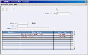

Your suppliers might organize their products into different catalogs due to seasonal changes in products, different product lines, and so forth. If you maintain items in catalogs on the system, you can use the catalogs to locate and choose items to order.
If you maintain more than one catalog for a supplier, you must specify the catalog for which you want to view items. If the supplier has only one catalog, the system displays all items from that catalog.
After you locate a catalog, you can choose the items you want to order. The system enters each item you choose on an order detail line, along with the unit price for the item, as specified in the catalog.
To enter items using supplier catalogs
  1. Press F5 to Access Supplier Item Selection.
    Figure 5-8 Supplier Item Selection screen
    Description of Figure 5-8 follows
    Description of "Figure 5-8 Supplier Item Selection screen"
  2. On Supplier Item Selection, complete the following fields:
    • Branch/Plant
    • Supplier
    • Catalog
  3. Enter the quantity of each item you want to order and press Enter.
  4. On Purchase Order Workbench, review the order detail lines.

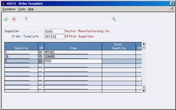

You can use order templates to locate lists of items that you frequently order and to choose items that you want to order.
Each order template contains a specific group of items. When you enter a purchase order, you can choose to review a certain template. From the template, you choose the items you want to order, and the system returns the items to the purchase order.
To enter items using order templates
  1. Press F8 to access Available Templates.
    Figure 5-9 Available Templates screen
    Description of Figure 5-9 follows
    Description of "Figure 5-9 Available Templates screen"
  2. On Available Templates, complete the following field:
    • Supplier
    If you entered a supplier on the purchase order, the system automatically displays all templates that were created for that supplier.
  3. Choose the template you want to view and press Enter.
    The system displays the order template.
    Figure 5-10 Order Template screen
    Description of Figure 5-10 follows
    Description of "Figure 5-10 Order Template screen"
  4. On Order Template, enter a quantity for each item you want to order and press Enter.
    You can also enter all items in their usual quantity by pressing F6.
  5. Review items and quantities on order detail lines.
Once you have entered items to order, Suppliers Selected For Order displays when you press F3 to exit the Purchase Order Workbench screen.
Figure 5-11 Suppliers Selected For Order screen
Description of Figure 5-11 follows
Description of "Figure 5-11 Suppliers Selected For Order screen"
  1. On Suppliers Selected For Order, verify that the system has combined all detail lines into a separate line for each supplier and branch/plant.
  2. Enter 1 in the following field to access Items Selected For Order:
    • O (Option Exit)
    Figure 5-12 Items Selected for Order screen
    Description of Figure 5-12 follows
    Description of "Figure 5-12 Items Selected for Order screen"
  3. On Items Selected For Order, review information about the individual items or accounts that make up a line on Suppliers Selected For Order.
  4. Press F3 to Return to Suppliers Selected For Order.
  5. On Suppliers Selected For Order, press F6 to have the system create a new purchase order for each supplier and branch/plant that appears.
