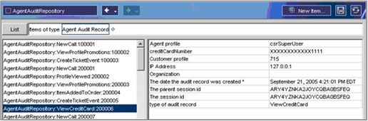

You can use the ACC to view these repository items:
Select the Content task area from the main ACC menu.
Select AuditAgentRepository from the submenu.
From the Items of Type drop-down list, select the type of item to view, and then click List.
If you select the first entry in the drop-down list, Agent Audit Record, the system displays all of the items in the repository, regardless of type. If you select any other entry, the system displays only the items of the specified type.
In the left pane, click the item to view.
The system displays the log information in the right pane. For example:
