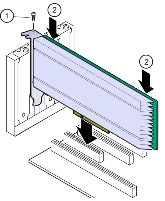

Insert Oracle F640 Flash Card in the supported PCIe slot.
Remove the blank bracket panel on the server chassis that aligns with
the empty PCIe slot. Save the bracket screw, if applicable.
Press down gently, but firmly, to properly seat the card in the slot.
The following figure shows how to insert Oracle F640 Flash Card in a PCI
Express slot.
Note -
Your server chassis might contain a card carrier or other configuration.
Refer to the server service manual for PCIe card installation instructions.
Secure the card bracket to the server chassis.
Engage the server retention mechanism to secure the card to the server
chassis.
Or, install the bracket screw, as required to secure the card to the server
chassis.
