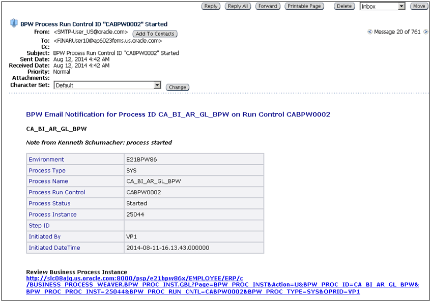

Email notifications use a generic template for all process status notifications and recipients. Email messages are sent in HTML format. Email note text is included in the email if it was entered when the notification was set up. The Email footer displays a URL link to the Business Process Instance Page.
This example illustrates the fields and controls on the Email Notification in Business Process Weaver.
Example of an Email Notification in Business Process Weaver

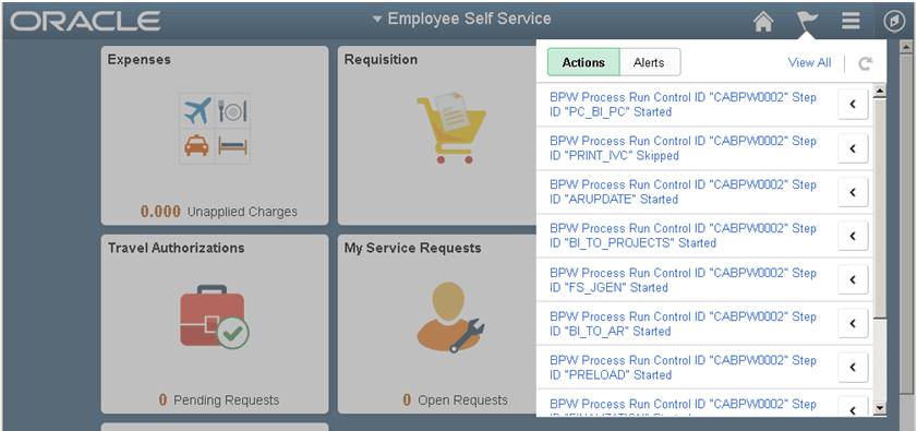

Push notifications are delivered in PeopleTools 8.54 and available in Fluid mode. Select the NavBar then Fluid Home. The flag icon shows a counter for new push notifications. Note that the counter disappears once you view the push notification list.
This example illustrates the fields and controls on the Push Notification in Business Process Weaver.
Example of a Push Notification in Business Process Weaver

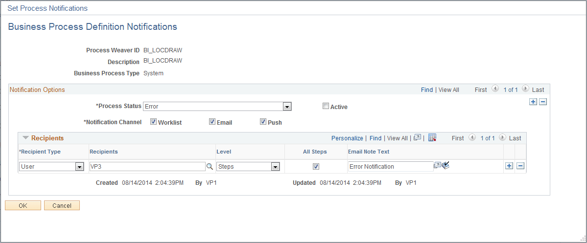

Use the Business Process Definition Notifications page (BPW_NOTIFYDEF_SEC) to select the process status, channel, and recipients for the notification. Channels include email, push, and worklist.
Navigation:
Background Processes, and then Business Process Weaver, and then Business Process Instance. Select the Notifications link.
This example illustrates the fields and controls on the Business Process Definition Notifications page. You can find definitions for the fields and controls later on this page.

Process Status
Select from a list of all existing process statuses except the Not Started value.
Notification Channel
Select at least one channel from these options:
  • Worklist - Creates a worklist entry for the recipients. This is the default option if no channels have been selected for the process status.
  • Email - Sends an email to the recipients. In addition, a custom text field is available by recipient row with this option. The information entered in the Email Note Text field appears on the email.
    Note:When the Notification Composer check box is selected on the Installation Options - Overall page, this option is hidden.
  • Push - Generates a push notification item on the PeopleSoft Fluid User Interface Home page for the recipients. Push functionality is available only with PeopleTools 8.54.
  • Notification ID - select BPWProcessStatusRequester or a user-defined notification ID.
    Note:When the Notification Composer check box is not selected on the Installation Options - Overall page, this option is hidden.
Notification links take the user to the Business Process Instance Page.
Active
Select to indicate that this process status notification is available for use. When selected, the notification options associated with this processes status are available to be inherited on the Business Process Run Control page. At least one notification must be active on the process definition to inherit notifications.
Recipients
Recipients’ routing preferences must include Worklist User and Email User on their user profile (go to PeopleTools, and then Security, and then User Profiles, and then User Profiles - Workflow) before they can receive email and worklist notifications.
Field or Control Description
Recipient Type and Recipients
Select from User or Role. User is the default value. Depending on the recipient type, enter recipients. The available recipients change based on the selected recipient type.
Level
Select from these options:
  • Process: Indicates that the notification criteria apply to the process level. Select to notify recipients anywhere in the process that the Process Status occurs.
  • Steps: Select to notify recipients at specific steps in the process. If you select this option, then you can also select specific steps or All Steps for notification. If you select all steps, then for each step, if the Process status occurs, a notification will be sent.
For example, you could set a notification for Process Status of Complete. If you set this at the Process level, the notification would be sent when the Process completes. If you set it at the Step Level for All Steps, then a notification would be sent when each step is Complete.
All Steps
Available only when the selected Level is Steps.
Select the All Steps option to send a notification for the selected process status to recipients at each step of the process.
Select and Steps
Available for the Step level when the All Steps check box is not selected.
Click the Select icon to open a secondary page, where you can select from the list of steps in the process definition. The Steps field lists the steps selected for notification.
Email Note Text
Available only when the selected Notification Channel is Email. Enter custom text that will be displayed on the email notification.

    Push notifications appear in the page banner. The notification flag icon shows the number of alerts that have been generated. Click the alert links to access the push notifications on the Business Process Instance page.
    Push notification functionality is delivered in PeopleTools 8.54.
