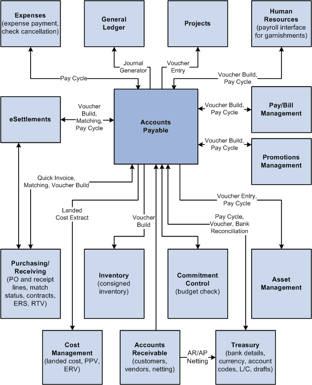

The following diagram illustrates how PeopleSoft Payables integrates with other PeopleSoft products.
PeopleSoft Payables integrations with other PeopleSoft products
