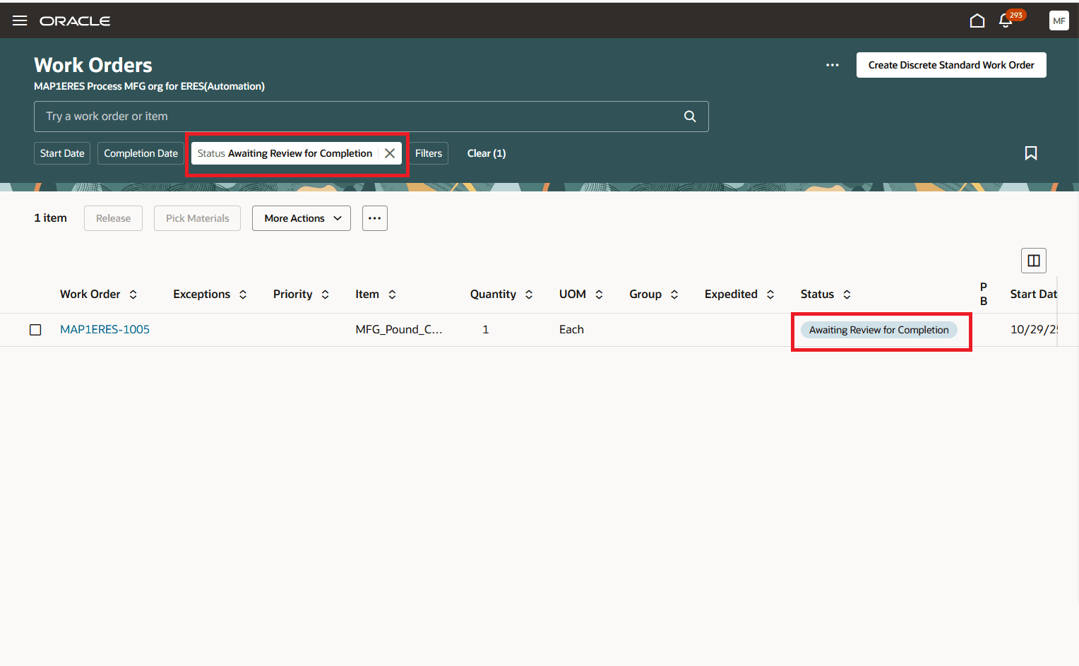

- Search and filter work orders based on new statuses: Use the filter for work order statuses to find a work order that has finished production execution and reporting activities using the Work Orders page. The Work Orders page can be accessed from the Actions list on the Work Execution landing page. Alternatively, use the Production Supervision action and select the Work Orders tab to access the page.
- Awaiting Review for Completion status - The last operation of the work order has been completed, and the work order is under review and awaiting submission for completion approval.
Work Orders Awaiting Review for Completion

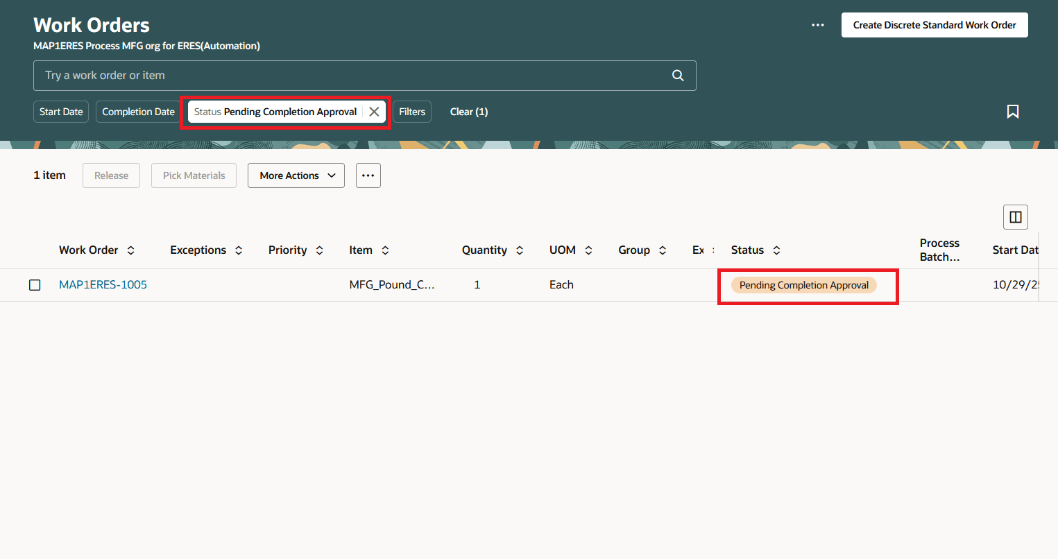

- Pending Completion Approval status - The work order has been submitted for completion approval and is awaiting the outcome of the approval process.
Work Orders Pending Completion Approval

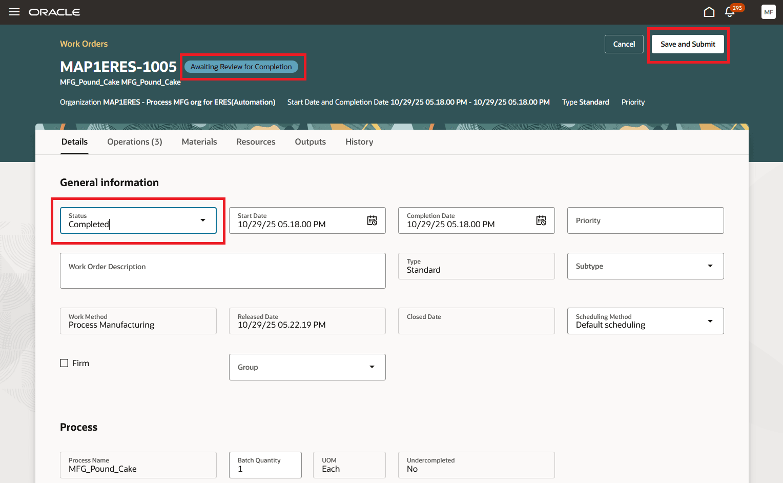

- Submit a work order for completion approval: Use the Work Orders page to submit the work order:
- Submit the selected work order for completion approval using an e-record and e-signature workflow process to ensure formal controls for authorized changes. The work order can be accessed from either the Work Orders (New) page or the Production Supervision page.
Submit Work Order for Completion Approval
- A new deferred process for viewing the generated e-record and capturing e-signatures for work order completion is initiated, changing the work order status to Pending Completion Approval and setting the work order to view only mode.

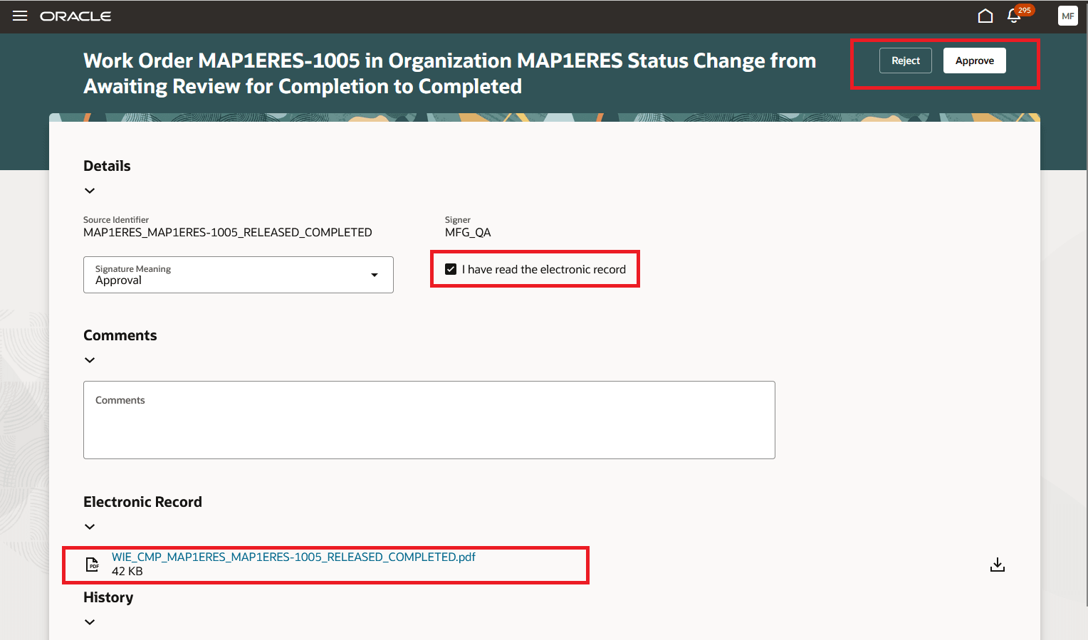

Review for Completion Approval

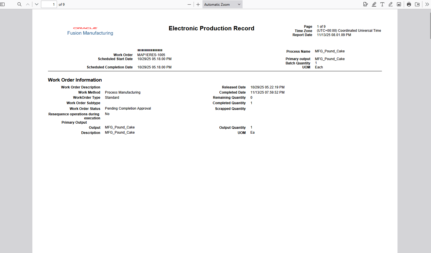

- Review the automatically generated electronic production record during the e-signature approval process.
Electronic Production Record
- Obtain approvals for work order completion or reject to roll back to the previous status and make changes for resubmission.
- If sign-off is not required, you can directly change the work order status from Awaiting Review for Completion to Completed without enabling the approval workflow.

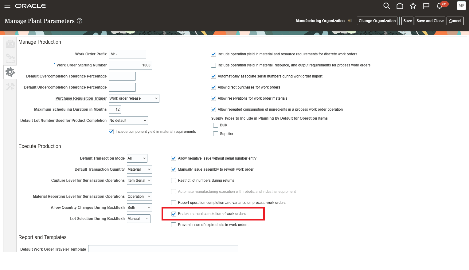

- Set up the plant parameters to enable this feature:
- In the Setup and Maintenance work area, search for, and select the Manage Plant Parameters task.
- On the Manage Plant Parameters page, select the required inventory organization.
- In the Work Execution tab, under Execute Production, enable the Enable manual completion of work orders checkbox.
Enable Manual Completion of Work Orders in Plant Parameters
