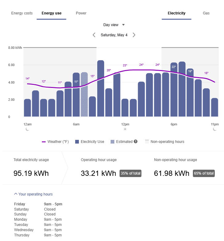

Operating Hours
For business customers who have subdaily smart meter (AMI) data, an additional insight about operating hours displays below the bar graph when the Day view is selected. The insight shows the total daily energy usage, operating hour usage, and non-operating hour usage. The operating hour and non-operating hour details are based on what is entered in the Business Profile. This information helps business customers understand how their energy usage is related to the times when they are open and closed for business.
This image shows an example of the operating hours insight below the energy use bar graph. The insight shows how much energy was used during operating hours and non-operating hours.
The bar graph displays extra background shading for non-operating hours of the day so that business customers have an additional visual reference point for their usage. At the bottom of the insight, an expandable menu displays the operating hours for quick reference.
If the business customer hasn’t added any operating hours yet, no data is displayed, and a link appears to prompt the customer to add the hours in their profile.
