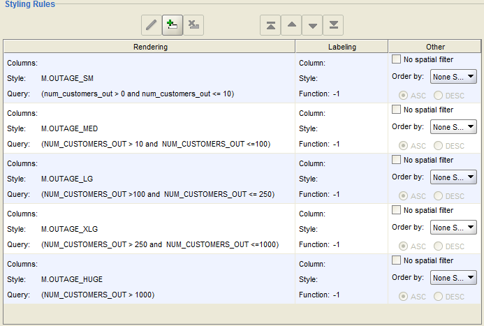

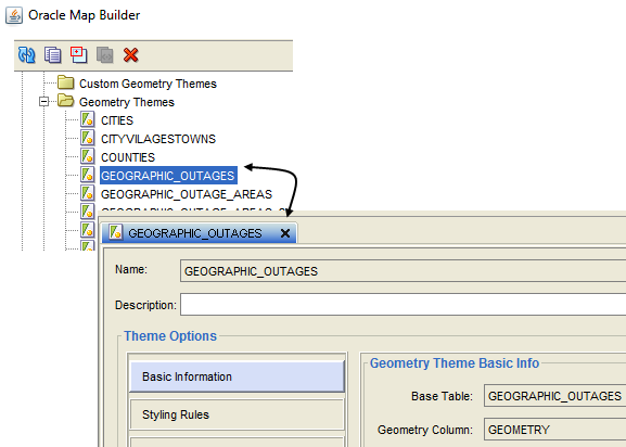

Column Name | Data Type | Description |
outage_type | VARCHAR | A description of the outage type. "Probable Service Outage", as mapped from the JOBS.status |
num_customers_out | NUMBER | The number of customers out, as mapped from the JOBS.user_cust_out. |
begin_time | DATE | The outage begin time, from JOBS.begin_time. |
est_rest_time | DATE | The outage estimated restore time, from JOBS.est_rest_time. |
last_update_time | DATE | The outage last updated time, from JOBS.last_update_time. |
cause | VARCHAR | The outage cause, if available. |
geometry | MDSYS.SDO_GEOMETRY | The geographic geometry, from DIAGRAM_OBJECTS.geo_geometry. |

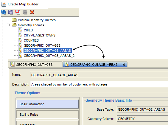

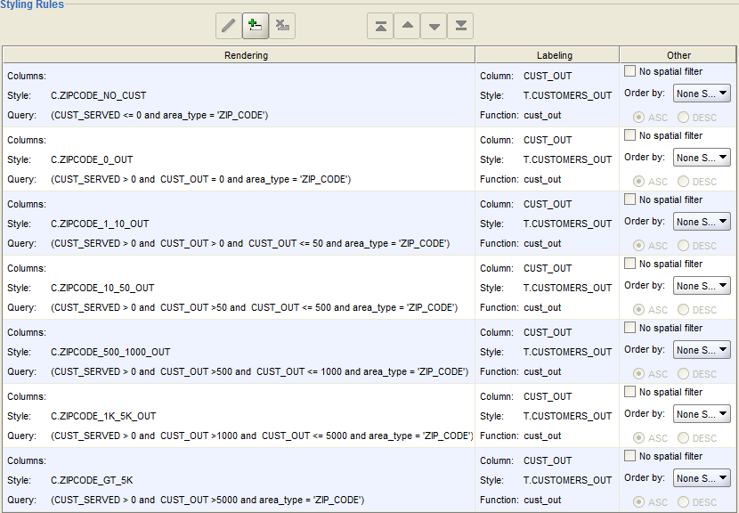

area | VARCHAR | The name of the outage area, from the CUSTOMER_SUM.zip_code, CUSTOMER_SUM.City_State, or CUSTOMER_SUM.User_Geographic_Loc. |
area_type | VARCHAR | Area type choice; for example, zip code, county, city. |
cust_served | NUMBER | The number of customers in the area, as summed from CUSTOMER_SUM.customer_count for that area. |
cust_out | NUMBER | The number of customers out in the area, as summed from CUSTOMER_SUM.customer_count for the supply_nodes with outage, |
num_outages | NUMBER | The number of distinct active JOBS table records. |
earliest_begin_time | DATE | The earliest outage begin time in the area, from the JOBS.begin_time. |
latest_est_rest_time | DATE | The last JOBS.est_rest_time for the area. |
last_update_time | DATE | The last JOBS.last_update_time for the area. |
geometry | MDSYS.SDO_GEOMETRY | The ZIP_CODES.geometry for the area. |
