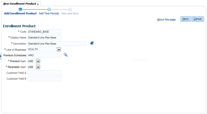

The creation of an enrollment product is a two step process:
  • Add basic details of the enrollment product - code, description, line of business, type and the enrollment product time period(s)
  • Add other details - products, adjustments, add-ons, parameter domain values or default parameter values for the enrollment product via the enrollment product page
When a user clicks on "New Enrollment Product", this opens a page to add a new enrollment product. Upon completion of the basic details, the application opens the "Enrollment Product" page in the same tab, with the basic information about the newly added enrollment product. Here, other details can be configured.
The page for a new enrollment product shows a configuration wizard which guides the user through the next steps. Back and forth navigation is possible using the "Back" and "Next" buttons.
Step 1: Add Enrollment Product
New Enrollment Product - Step 1
The basic details about the enrollment product can be added here.
Field Description
Code
The unique code of the enrollment product
Display Name
The display name of the enrollment product
Description
The description of the enrollment product
Line of Business
The line of business of the enrollment product
Premium Schedules
The premium schedules of the enrollment product (multi-value field)
Premium Currency
The currency for the adjustment and add-on amounts specified on the enrollment product (all adjustments and add-ons will have the same currency)
Parameter Currency
The currency for the parameter amounts specified on the enrollment product (all parameters of type amount will have the same currency)
Dynamic Fields
Dynamic fields configured for enrollment products. Only single-value dynamic fields are displayed.

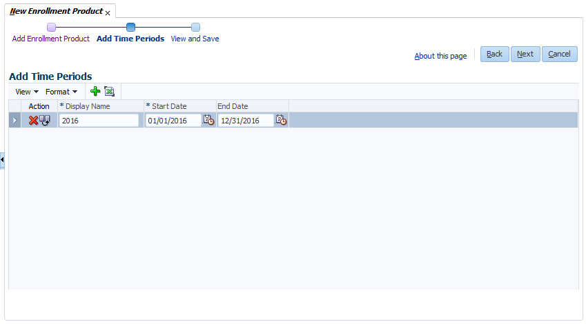

Step 2: Add Enrollment Product Time Periods
New Enrollment Product - Step 2
Enrollment product time period(s) can be configured here. The following fields are available:
Field Description
Display Name
The display name of the enrollment product time period. Unique for the enrollment product.
Start Date
The start date for the enrollment product time period
End Date
The end date for the enrollment product time period

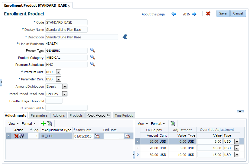

Adjustments
Adjustment types (that is, the adjustments that apply) and adjustment sequences (that is, the order in which the adjustments apply) for the enrollment product can be entered here. These enrollment product 'assigned' adjustments have their own time validity (start and end dates), so they are not in the context of the selected enrollment product time period. The user however does have the option to override the adjustment values for the available adjustment rules within the context of the selected enrollment product time period. More information on the adjustment setup can be obtained from the section "Adjustment Rules" in the premium configuration guide.
Enrollment Product - Adjustments
There are two sub sections:1) To add enrollment product adjustments and 2) To view the adjustment rules and adjustment values.
The following fields can be entered in the first section:
Field Description
Sequence
The sequence in which the different types are calculated
Adjustment Type
The schedule definition of the type adjustment
Start Date
The start date of the assignment of the adjustment
End Date
The end date of the assignment of the adjustment
The adjustments are calculated in the ascending order of the sequence. This is especially relevant for the adjustments that are based on a percentage. The adjustment types having the same sequence, say N, take the same base amount for the percentage based adjustment calculations and it is premium - all the adjustments up to and including (N-1) sequence. More information on how adjustment amounts are evaluated can be found in the implementation guide for premium calculation.
The second section is shown in the context of the first section. The following fields are available:
Fields Description
All columns as specified under the Adjustment Type
Adjustment
Specifies the amount (including currency) or percentage by which the premium is adjusted
Override Adjustment

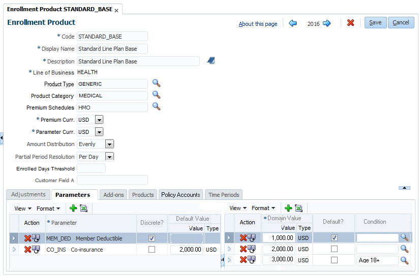

Parameters
The enrollment product specific parameters can be configured here. Refer to the section "Schedule Definition" in the premium configuration guide for the details on parameters.
Parameters are either discrete or non discrete. Discrete parameters have the possibility to enter a list of domain values from which the user can choose when the enrollment product is selected in a policy. One of the domain values must be marked as the default value. A dynamic logic condition can be attached to a domain value to limit the availability of the domain value in a policy (for example, a certain value is only available for person with an age of 18 years or above).
Non discrete parameters do not have the option to define a list of possible values. For a non discrete parameter, it is only possible to define a default value for the parameter.
Enrollment Product - Parameters
The following fields can be entered:
Parameter section
Field Description
Parameter
The parameter alias to which the parameter domain belongs
Discrete?
Indicator the defines whether the parameter domain contains a list of discrete domain values or that the parameter domain has a non discrete value.
Default Value
Specifies the default amount (including currency), percentage or number for the parameter. The type is defined on the selected parameter alias. This field is only enabled for non discrete parameter domains
Parameter domain values section (only enabled for discrete parameter domains)
Field Description
Domain Value
Specifies the amount (including currency), percentage or number for the parameter. The type is defined on the selected parameter alias.
Default?
Indicator that defines which value is the default value for the parameter domain in the context of the enrollment product
Condition
Code of the dynamic logic condition that applies to the domain value.
Start Date
The start date of the parameter domain value.
End Date
The end date of the parameter domain value.

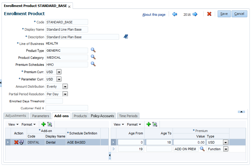

Add-ons
The add-ons that can be offered on the policy in addition to the enrollment product.
enrollmentproduct addons 1
There are two sub-sections:1) To add add-on premium schedules and 2) To add add-on premium schedule lines in the context of an add-on premium schedule.
The following fields are available for the add-on premium schedules:
Field Description
Add-on
Specifies the add-on (code and display name) that is packaged by the enrollment product
Schedule Definition
Specifies the schedule definition used by the add-on premium schedule
The add-on premium schedules are added within the context of the selected enrollment product time period.
The second section is shown in the context of the first section. The following fields are available for the add-on premium schedule lines:
Field Description
All columns as specified under the Schedule Definition
Premium
Products

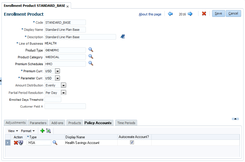

Policy Accounts
The policy account types valid for the enrollment product.
Enrollment Product - Policy Accounts
The following fields are available for the policy accounts:
Field Description
Type
The type of the policy account that is available for the enrollment product.
Display Name
The display name of the policy account type available for the enrollment product.
Autocreate Account?
Indicates whether a policy account of this type is created automatically for policies based on this enrollment product.
The policy account is not added within the context of the selected enrollment product time period because it is time independent.

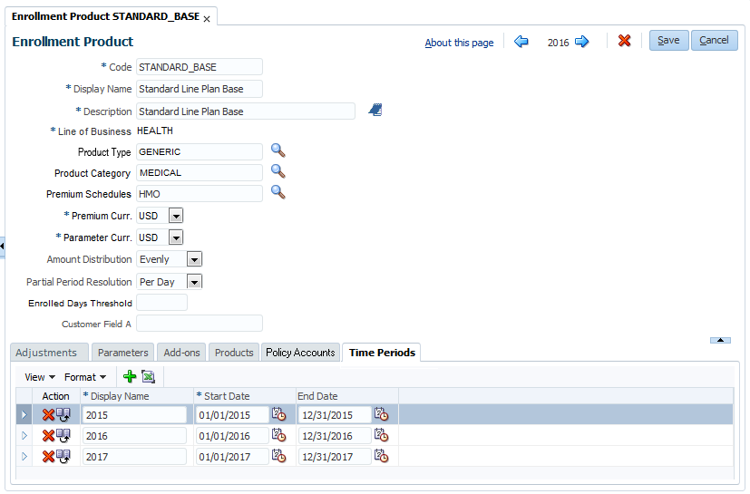

This is a time period, that is, a slice of time that is used in the context of the enrollment product. They are used to enable the enrollment product adjustment values and parameter values to change over time. Refer to the section "Time Period" in the Premium Configuration guide for details on the time period.
Enrollment Product - Time Periods
Field Description
Display Name
Start Date
End Date
