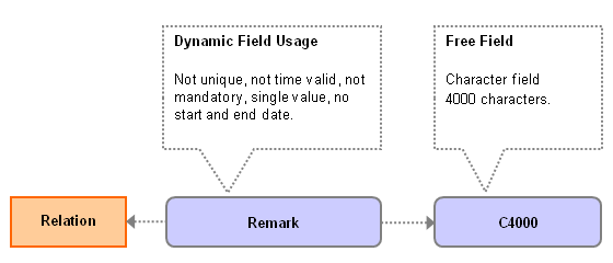

Scenario 1
A customer wants to extend the relation table with a field that captures a user remark. Creating a new field is a two step process. The first step is to create a new field (definition), the second step is to create the link between that field and the entity to which it is added.
The user creates a new field with the code 'C4000'. The description is 'Generic text 4000 chars', data type is 'char' and maximum length is '4000'. There is no need to set the decimal and validation properties.
The user creates a new dynamic field usage for the relation table. The name is 'remark' and the display name is 'Remark'. The customer sets the display sequence to 1, meaning that in the standard pages for persons and organizations, this is the first dynamic field listed in the designated section. The free field 'C4000 is referenced'.
The value of the remark field is not unique, has only a single value, is not (conditionally) mandatory and is not time valid. There is no condition on whether or not a value is allowed. There are no time constraints that determine whether or not a remark is allowed. The result of our setup is that the Relation page now shows a new field, labeled 'Remark' that may contain up to 4000 characters.

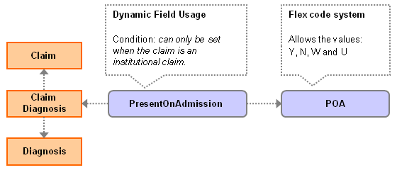

Scenario 2
Whenever a diagnosis is specified on an incoming institutional (hospital) claim, the user wants to know whether or not the diagnosis was present on admission (or whether the diagnosis was made after admission). This piece of information is an attribute of a diagnosis within the context of a particular claim, that is, the same diagnosis code can be present on admission on one claim, while not present on admission on another claim. For this reason the table that connects a claim with a diagnosis has to be extended with the indicator.
A 'present on admission' (POA) indicator is only applicable to institutional claim diagnoses and not for other types of claims, such as dental claims or professional claims. The user wants to ensure this through the correct setup.
The user sets up a flex code system named 'POA' that allows the following values:
N, meaning 'not present',
Y, meaning 'present',
U, meaning 'unknown',
W, meaning 'clinically undetermined'.
Specifics on how to set up a flex code system are detailed in Code Definitions. The user creates a new dynamic field usage for the 'Claim diagnosis' table, that is, the table that connects a diagnosis with a claim.
The dynamic field usage is set up as follows:
Name - PresentOnAdmission
Display name - 'Present on admission?'
Type - Code
Flex code system - POA
Condition - INST
Note that any fields that are not mentioned are left blank or unchecked. The condition 'INST' is a dynamic logic condition that takes the 'claim' to which the 'claim diagnosis' is attached and ensures that it is an institutional claim. This way, the user ensures that only institutional claims have a POA indicator on their attached diagnoses.
