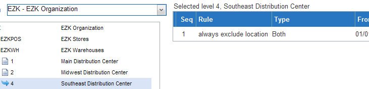

Options at this screen
| Option | Procedure |
| review the levels for rule assignment or review |
Sort order: This screen sorts all displayed records in alphanumeric order within each organization. In other words, organizations are listed alphanumerically by name, as are location types within an organization, and locations within a location type. Since the sort is alphanumeric, numeric codes are listed before alphabetical codes; for example, location 123 is listed before location ABC. |
| select location type or location for rule assignment or review, or select a different organization |
Highlight the location type or location to display the rules that are currently assigned at that level, or select a different organization from the drop-down list. Note that the currently selected location level is indicated above any assigned rules. |
| assign a probability rule |
Use the navigational fields in the left-hand pane to select the organization, location type, or location where the rule should apply, as described above. You can assign a rule at only one level at a time; however, rules you set at the organization level or location type level apply to all lower levels, unless they are overridden by another rule at a lower level. See Probability Rule Overview for background. Use the fields at the top of the screen to select the rule and optionally specify a date range or reset the Active flag. Rule not displayed? If you create or update the name of a probability rule while the Probability Location screen is open, the new or renamed rule is not available for assignment until you close the Probability Location screen and reopen it. |
| update a probability rule assignment |
| delete a probability rule assignment |
Note: Deleting a rule at the organization or location type level does not automatically delete a rule assignment for the same rule at a lower level in the hierarchy. Also, deleting a rule assignment does not delete the rule itself. |

Rule assigned? A blue arrow ( Note: To refresh the display of the blue arrows based on your activity at this screen, close the Probability Location screen and re-enter. |

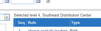

| Selected level |
When you highlight an organization, location type, or location in the left-hand pane, the code and description are displayed in the center of the screen above any rules that apply to the selection. ![]() |
