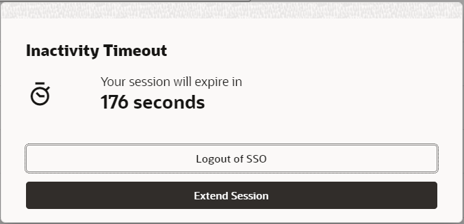

Associate UI Timeout
Enter the number of minutes that an inactive store associate session should remain open before timing out.
Inactivity warning: Three minutes before the associate’s session is due to time out, an Inactivity Timeout window indicates when the session will expire and provides an option to log out of SSO or extend the session.
Illustrates the Inactivity Timeout window, indicating when the session will expire and the options to log out or extend.
Your entry can be 15 to 1440 minutes. The default setting is 15 minutes. Required.
