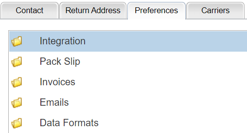

Preferences tab |
Each vendor preference category is available by clicking the folder in the left-hand tab. ![]() |

Preferences tab |
