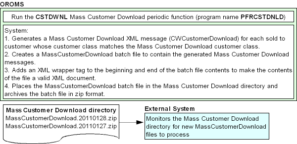

Mass Customer Download allows you to download a batch file of new and changed customers to an external system.
The download file contains a Mass Customer Download XML Message (CWCustomerDownload) for each sold-to customer whose customer class matches the customer class defined in the MASS_CUSTDWNLD_CUSTOMER_CLASS property.
Mass customer download process flow:

Mass Customer Download Process
Use the following steps to generate the Mass Customer Download file.
# Step
1.
Run the CSTDWNL Mass Customer Download periodic function (program name PFRCSTDNLD) to submit the CUSTDWLD job.
2.
Order Management System writes any messages related to the Mass Customer Download to the Application Log.
If the Mass Customer Download processes successfully, Order Management System writes a message similar to the following to the log:
Mass CustomerDwnld created in folder: \\APP1\OMSFiles\Integrations\Xlink\TEMP_MassCustomerDownload
If the Mass Customer Download fails, Order Management System writes a message similar to the following to the log and does not generate a Mass Customer Download XML Message (CWCustomerDownload) or create a Mass Customer Download File.
If a valid directory path does not exist in the MASS_CUSTDWNLD_DOWNLOAD_DIRECTORY property:
MASS_CUSTDWNLD_DOWNLOAD_DIRECTORY property not set. MassCustomerDwnld configuration error - Customer Download not processed
If a file name is not defined for the MASS_CUSTDWNLD_FILE_NAME property:
MASS_CUSTDWNLD_FILE_NAME property not set. MassCustomerDwnld configuration error - Customer Download not processed
3.
Order Management System looks at the setting of the MASS_CUSTDWNLD_CUSTOMER_CLASSES property to determine which customers to include in the Mass Customer Download.
  • If a customer class is defined, Order Management System generates a Mass Customer Download XML Message (CWCustomerDownload) for only those sold to customers whose customer class matches the customer class defined in the MASS_CUSTDWNLD_CUSTOMER_CLASSES property.
  • If a customer class is not defined, Order Management System generates a Mass Customer Download message for all sold to customers.
4.
Order Management System places the generated Mass Customer Download messages in a batch file. The setting of the MASS_CUSTDWNLD_FILE_NAME property determines the name of the batch file.
  • During processing, Order Management System adds the prefix TEMP to the name of the batch file; for example: TEMP_MassCustomerDownload
  • Once processing is complete, Order Management System adds a date and time stamp to the batch file name; for example: MassCustomerDownload.20110128.170150340
  • Order Management System also archives the batch file in zip format; for example: MassCustomerDownload.20110128.170150340.zip
See Mass Customer Download File for a sample file.
5.
If a value is defined for the MASS_CUSTDWNLD_MESSAGE_WRAPPER property, Order Management System adds this value to the beginning and end of the batch file contents to make the contents of the file a valid XML document.
6.
Order Management System places the Mass Customer Download File in the directory defined in the MASS_CUSTDWNLD_DOWNLOAD_DIRECTORY property so that it can be processed by an external system.

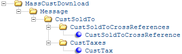

The Mass Customer Download message contains customer information to send from Order Management System to another system. See Generic Download Message Formatting for more information on how the system formats all download messages.
Mass Customer download batch file: The system includes all Mass Customer Download messages that are generated during the Mass Customer Download Process in a single batch file; see Mass Customer Download File for a sample file.
Sample: See Mass Customer Download Message: Sample Message for a sample message.
A sample of the Mass Customer Download XML Message (CWCustomerDownload) is presented below.
 <Message source="OROMS" target="cwi" type="CWCustomerDownload" date_created="2011-01-28" time_created="11:44:49" version="1.0">
 <CustSoldTo cst_action_type="X" cst_captured_by="PFR0103" cst_company="7" cst_cust_nbr="107" cst_prefix="MRS" cst_fname="MARY" cst_minitial="R" cst_lname="JOHNSON" cst_street_addr="24 EXAMPLE STREET" cst_addr_line_3="EXAMPLE PLACE LEAVE PACKAGES" cst_apt="STE 202" cst_city="WESTBOROUGH" cst_state="MA" cst_zip="01581-1528" cst_country="USA" cst_delivery_code="R" cst_po_box="N" cst_orig_mail_type="C" cst_associate="N" cst_auto_cancel_bo="N" cst_commercial="N" cst_entry_date="2011-01-28" cst_ghost="N" cst_inactive="N" cst_match_code="MARSU24P017" cst_bypass_reservation="N" cst_mail_name="N" cst_rent_name="N" cst_seed_name="N" cst_new_add_change="A" cst_email_opt_in="O1" cst_email_addr="msullivan@example.com" cst_do_not_fax="Y" cst_cust_class="WM" cst_cust_class_desc="EXAMPLE MASS CUST DOWNLOAD" cst_mail_code="N MAIL CODE" cst_create_user="KBROWN">
 <CustSoldToCrossReferences>
 <CustSoldToCrossReference cst_alternative_cust_nbr="2" />
 <CustSoldToCrossReference cst_alternative_cust_nbr="549" />
 </CustSoldToCrossReferences>
 <CustTaxes>
 <CustTax cst_tax_country="USA" cst_tax_state="MA" cst_tax_code="T"/>
 </CustTaxes>
 </CustSoldTo>
 </Message>
This file contains each Mass Customer Download XML Message (CWCustomerDownload) that is generated during the Mass Customer Download Process. The setting of the MASS_CUSTDWNLD_FILE_NAME property determines the name of the batch file.
If a value is defined for the MASS_CUSTDWNLD_MESSAGE_WRAPPER property, Order Management System adds this value to the beginning and end of the generated file to make the contents of the file a valid XML document.
Order Management System places the Mass Customer Download file in the directory defined in the MASS_CUSTDWNLD_DOWNLOAD_DIRECTORY property so that it can be processed by an external system.
Sample Mass Customer Download file: A sample of the Mass Customer Download file is presented below. In this example MassCustDwnld is defined in the MASS_CUSTDWNLD_MESSAGE_WRAPPER property.
