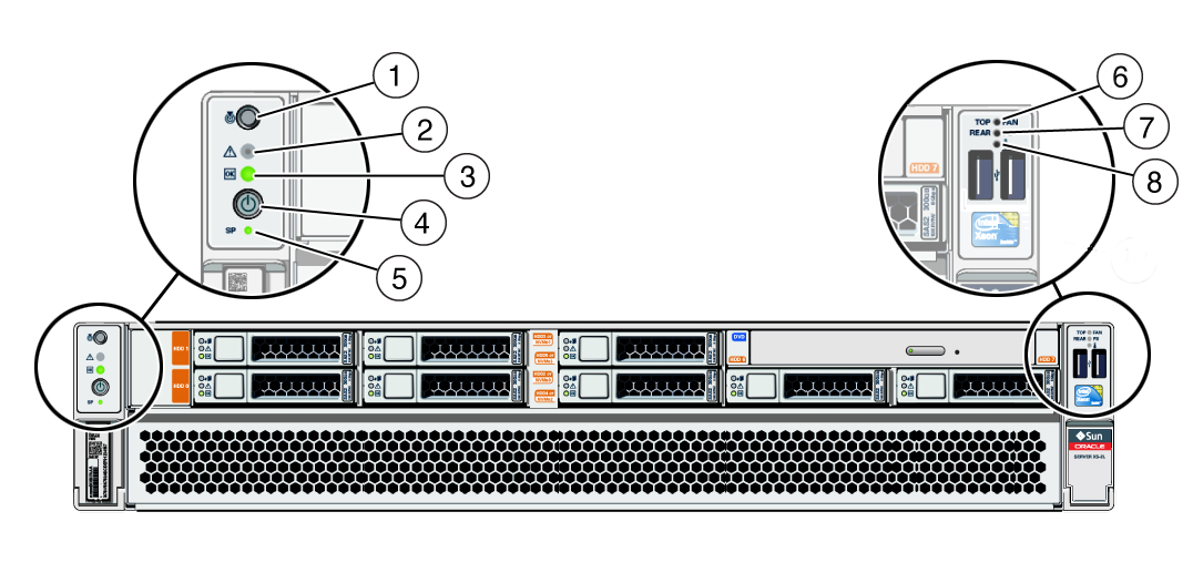

1
System Server Locator LED and button (white)
You can turn on the Locator LED to identify a particular
server. When lit, the LED blinks rapidly. The blinking will time
out after 15 minutes. Turn on the Locator LED by pressing the
Locator button, or see Locate the Server.
2
Service Required LED (amber)
Under some fault conditions, individual component fault LEDs
are lit in addition to the Service Required LED.
3
Power OK LED (green)
Indicates these conditions:
Off – Server
is not running in its normal state. Server power might
be off. The SP might be running.
Steady on –
Server is powered on and is running in its normal
operating state. No service actions are required.
Fast blink –
Server is running in standby mode and can be quickly
returned to full function.
Slow blink –
A normal but transitory activity is taking place. Slow
blinking might indicate that server diagnostics are
running or that the server is booting.
4
5
SP OK LED
SP
Off – AC
power might have been connected to the power
supplies.
Steady on, green
– SP is running in its normal operating state. No
Blink, green
– SP is initializing the Oracle ILOM
firmware.
Steady on, amber
– An SP error has occurred and service is
required.
6
Fan Module Fault LED (amber)
FAN
Off – Steady
state, no service action is required.
Steady on – A
fan module failure event has been acknowledged and a
service action is required on at least one of the fan
modules.
7
Server Power Supply Fault LED (amber)
PS
Off – Steady
Steady on – A
fault has been detected on one of the two power
supplies.
8
Server Overtemp LED (amber)
Off – Steady
Steady on – A
temperature failure event has been acknowledged. A
temperature limit has been exceeded, and a service
action is required.
