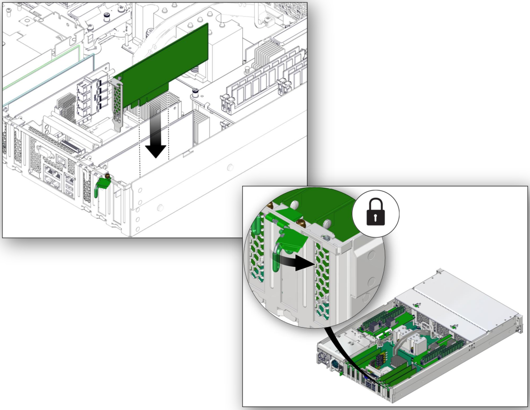

![]() | Caution - This procedure requires that you handle components that are sensitive to ESD. This sensitivity can cause the component to fail. To avoid damage, ensure that you follow antistatic practices as described in ESD Measures. |
If you are not replacing an existing PCIe card and need information about deciding which slot to install the card in, see PCIe Card Configuration.
The locking mechanism might already be disengaged if you removed a PCIe card or filler from that slot.
See Attach Power Cords.
See Power On the Server (Oracle ILOM) or Power On the Server (System Power Button).
