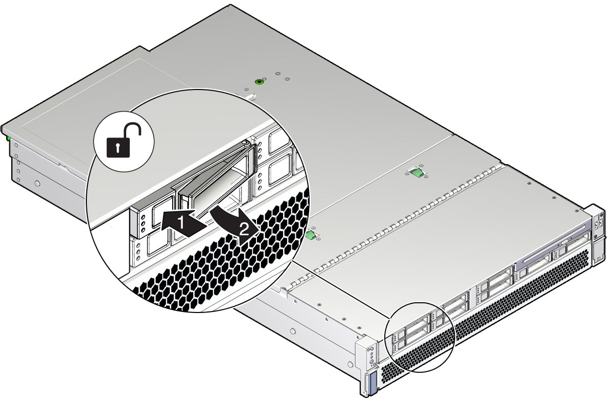

In this state, the blue OK to Remove LED on the NVMe drive is lit.
![]() | Caution - The latch is not an ejector. Do not bend it too far to the right. Doing so can damage the latch. |

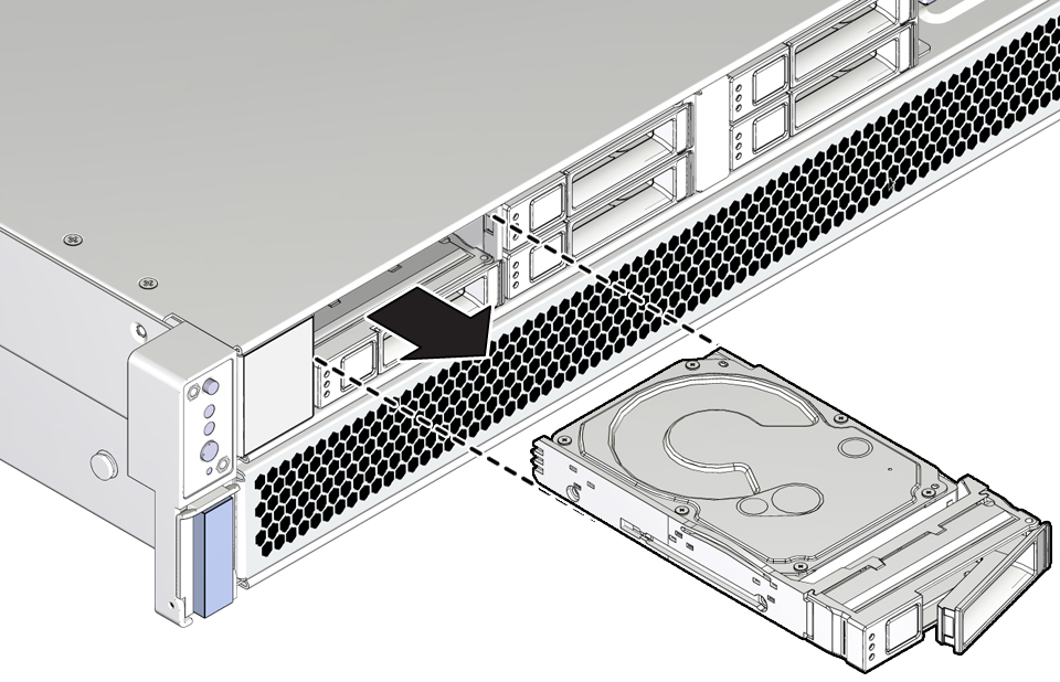

![]() | Caution - When you remove a drive, replace it with a drive filler or another drive. Otherwise, the server might overheat due to improper airflow. |
# hotplug list -lc
