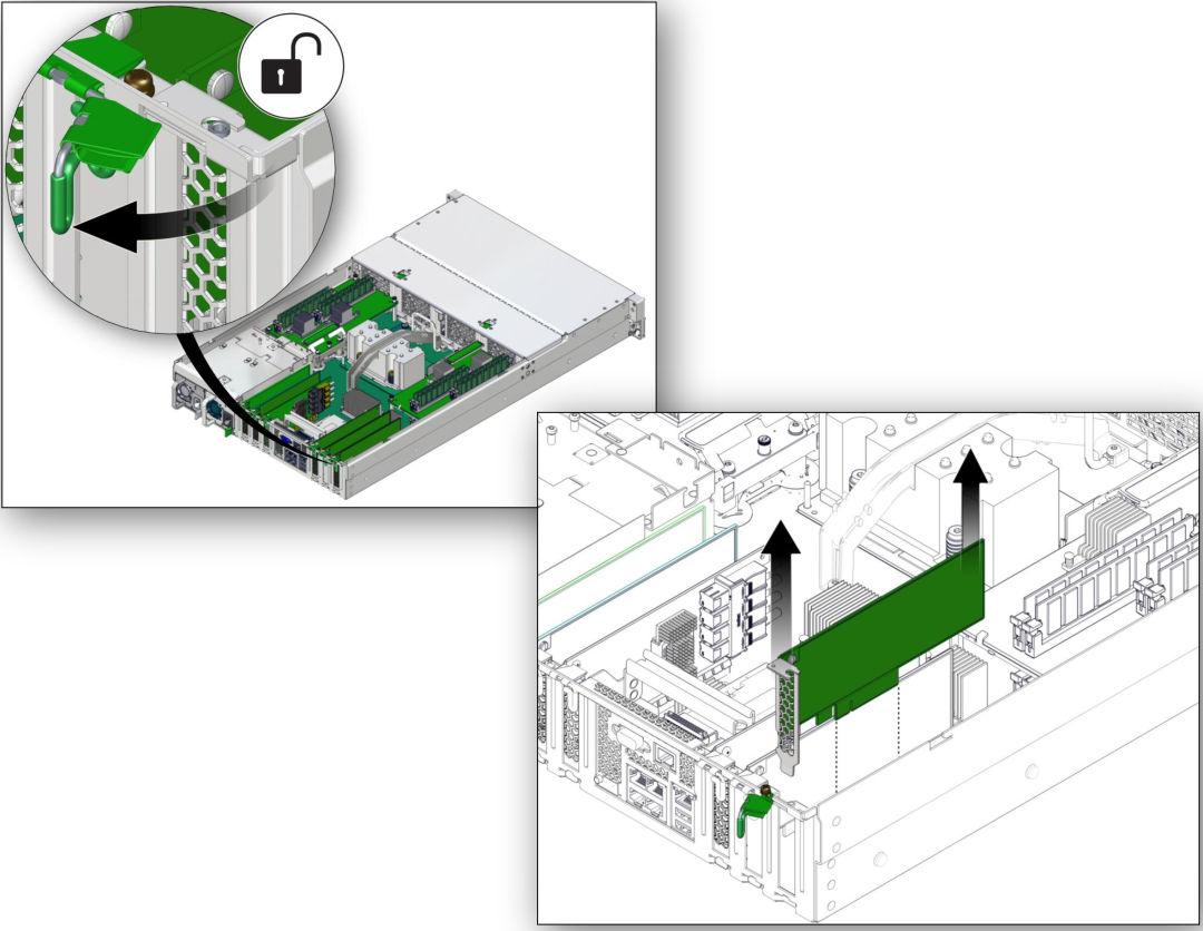

Remove the PCIe card by completing the following tasks.
Rotate the PCIe card locking mechanism (panel 1).
Carefully lift the PCIe card or filler from the card slot (panel 2).
