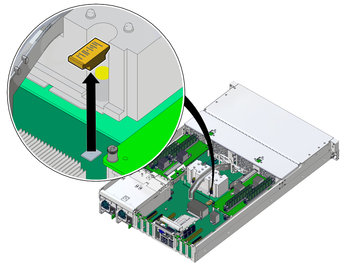

Note -
When replacing the motherboard, remove the SC PROM from the old
motherboard and install that component on the new motherboard. The SC PROM contains the
system host ID and MAC address. Transferring this component preserves
system-specific information. The SP is built into the motherboard, not on
a separate card as on some earlier servers.

- Remove the SC PROM from the motherboard.
You will reinstall it on the new motherboard.

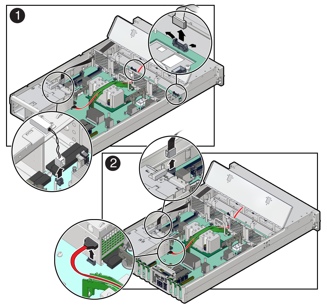

Disconnect the ribbon cables from the motherboard that go to
the left and right LED indicator modules (panel 1).
The right LED indicator module include the front USB 2.0 ports. The left and right LED
indicator modules do not need to be removed to replace the motherboard.
Disconnect the cable from the server intrusion switch (panel 1).
Disconnect the signal cable and power cable from the motherboard to the drive
backplane.
See Remove the Eight-Drive Backplane.

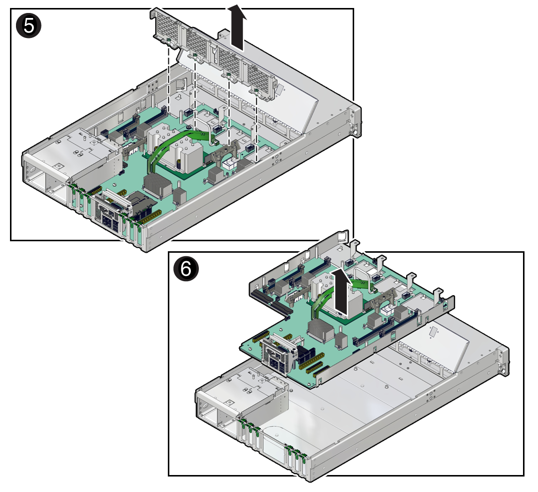

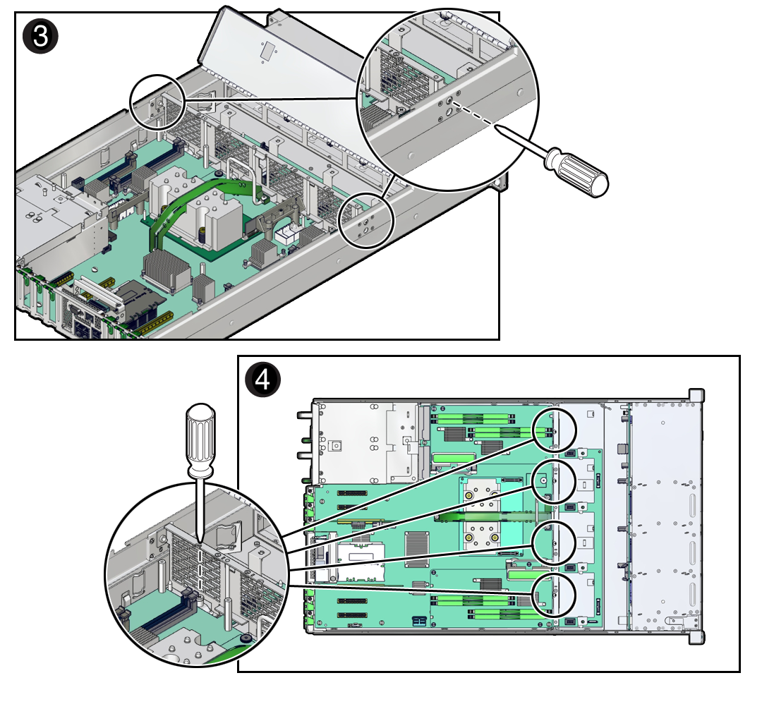

Disconnect the mid-wall from the chassis.
Remove the screw on each side of the chassis that secures the mid-wall
to the chassis (panel 3).
Loosen the four green captive screws that secure the mid-wall to the bottom of the chassis (panel 4).
Use a No. 2 Phillips screwdriver to loosen the captive screws.
Lift the mid-wall out of the chassis (panel 5)

Lift the motherboard out of the chassis.
You can use the bar by the rear I/O panel and the metal handle in front of the cable
channel as handles to lift the motherboard. Slide the motherboard slightly
towards the front of the server and then lift it out of the chassis.
