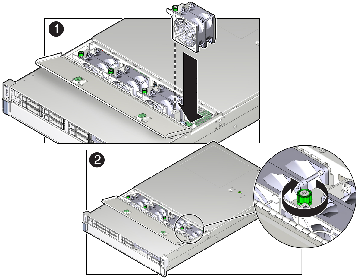

![]() | Caution - To ensure proper cooling, ensure that you install the replacement fan module in the same slot from which the faulty fan was removed. |
See Remove a Fan Module.
Ensure that the cables threaded between the two middle fan modules are not caught.
You will hear a click when the fan module is properly seated.
This screw should only be finger tight. Do not use a screwdriver to tighten it.
See Verify a Fan Module.

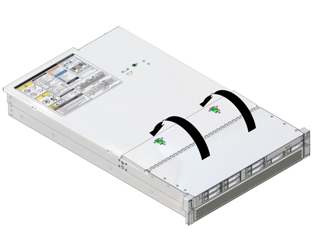

Swing the fan door closed, then press down until the two green buttons snap into place.
