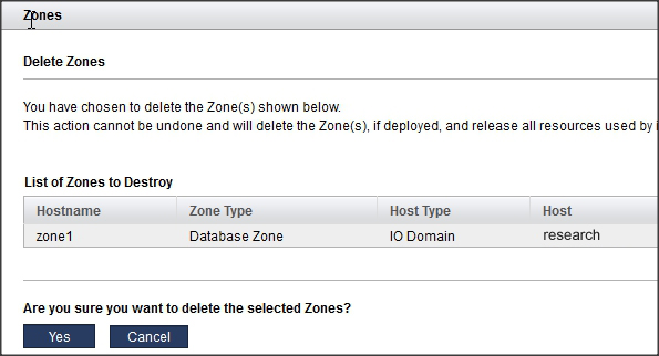

Removing a zone from a Database Zone Domain removes the zone configuration information from the assistant.
  1. Access the SuperCluster Virtual Assistant.
    See Log In to the SuperCluster Virtual Assistant.
  2. In the navigation panel, select Zones.
  3. Select the check box next to the zone whose configuration you want to remove and click Delete.
  4. Click Yes to remove the configuration information for this zone.
    image:Screen shot showing the Delete Zones page.
    Tip  -  After you remove the zone's configuration from its I/O Domain, you should remove the deleted zone's host and IP information from DNS.
