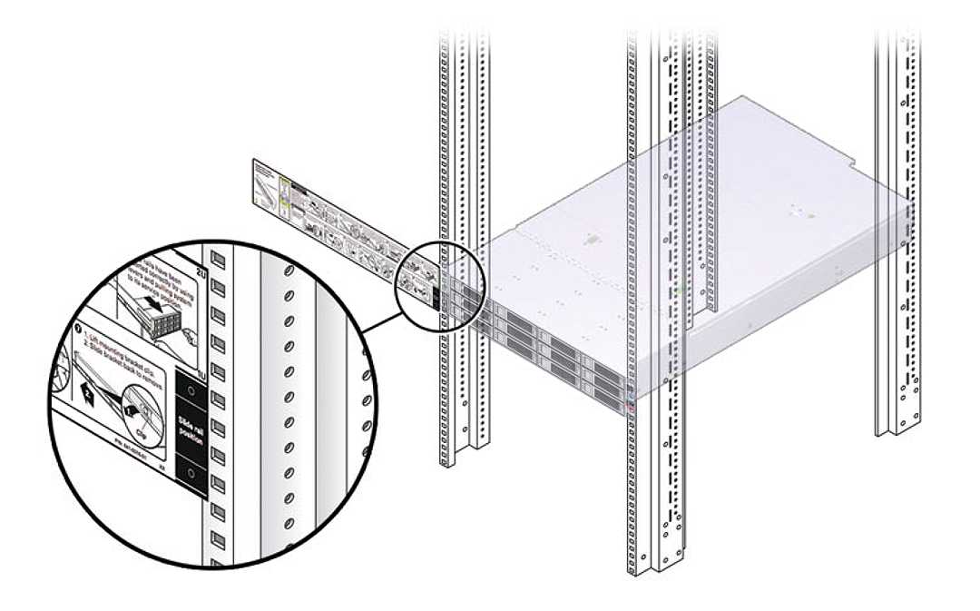

Use the rackmount installation card to identify the correct mounting holes for the slide-rails.
Note - Load the rack from bottom to top.
  1. Ensure that there is enough vertical space in the cabinet to install the storage server.
    See Rack Requirements.
  2. Place the rackmount installation card against the front rails.
    The bottom edge of the card corresponds to the bottom edge of the storage server. Measure up from the bottom of the installation card.
    image:Figure showing the installation card being used for rackmount location.
  3. Mark the mounting holes for the front slide-rails.
  4. Mark the mounting holes for the rear slide-rails.
