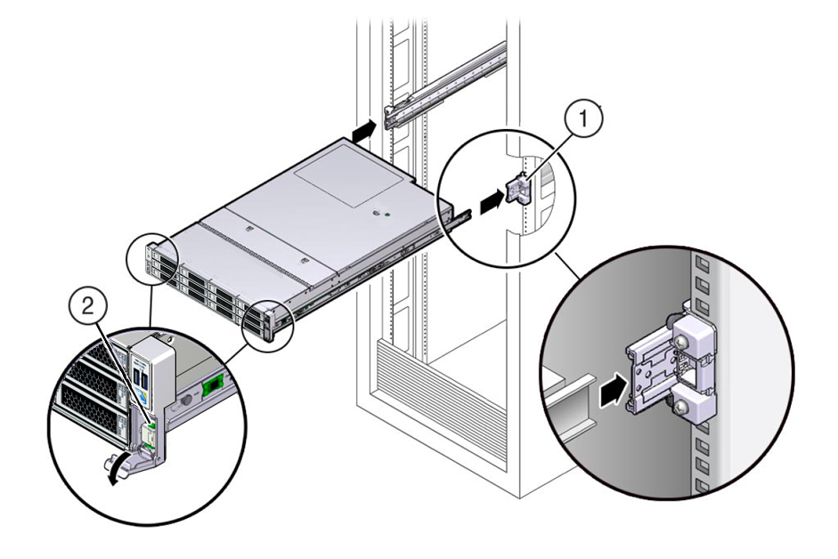

  1. Push the slide-rails into the slide-rail assemblies in the rack as far as possible.
  2. Position the storage server so that the rear ends of the mounting brackets are aligned with the slide-rail assemblies that are mounted in the rack.
  3. Insert the mounting brackets into the slide-rails [1], and then push the storage server into the rack until the mounting brackets encounter the slide-rail stops (approximately 12 inches, or 30 cm).
    image:Figure showing the storage server with mounting brackets being inserted into the Slide-Rails.
  4. Simultaneously pull down and hold the slide-rail release levers on each mounting bracket [2] while you push the storage server into the rack until the slide-rail locks (on the front of the mounting brackets) engage the slide-rail assemblies.
    You will hear an audible click.
    image:Figure showing the storage server being pushed back into the rack.
    Caution
    Caution  - Verify that the storage server is securely mounted in the rack and that the slide-rail locks are engaged with the mounting brackets before you install the optional cable management arm.
