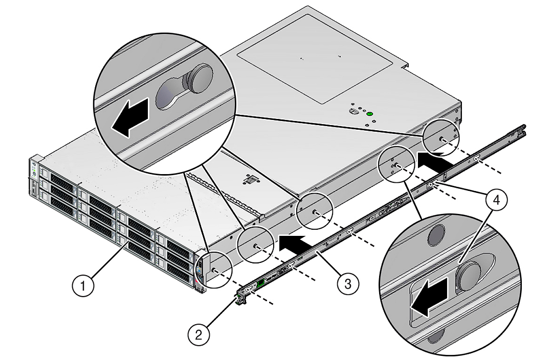

  1. Position a mounting bracket against the chassis so that the slide-rail lock is at the storage server front, and the five keyhole openings on the mounting bracket are aligned with the five locating pins on the side of the chassis.
    image:Figure of mounting bracket aligned with storage server chassis locating pins.
    Figure Legend
    Description
    1
    Chassis front
    2
    Slide-rail lock
    3
    Mounting bracket
    4
    Mounting bracket clip
  2. With the heads of the five chassis locating pins protruding through the five keyhole openings in the mounting bracket, pull the mounting bracket toward the front of the chassis until the mounting bracket clip locks into place with an audible click.
  3. Verify that the rear locating pin has engaged the mounting bracket clip.
  4. Repeat Step 1 through Step 3 to install the remaining mounting bracket on the other side of the storage server.
