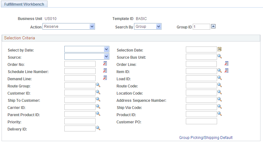

Fulfillment Workbench Page
Use the Fulfillment Workbench page (IN_FW_SELECTION) to Create a request to move material stock orders and sales orders from one fulfillment state to another.
Navigation:
Inventory, and then Fulfill Stock Orders, and then Fulfillment Workbench
This example illustrates the fields and controls on the Fulfillment Workbench page. You can find definitions for the fields and controls later on this page.
The exact fields and field values available on this page are determined by the template ID.
Field or Control Description
Action
Select Pick Confirm to enable you to provide picking feedback results for demand lines. Depending on how auto-processing options are set, you can also move these demand lines to a confirmed, shipped, or depleted state.
Search By
Select the level that you want to search for and process demand. Based on the option selected, the fields that appear on the Fulfillment Workbench component will vary. Values are:
  • Group: Select to display group-level fields to search and retrieve demand data.
  • Detail: Select to display detail-level fields to search and retrieve demand data.
Group ID
Enter a group identification code for the request that you are creating to allow these transactions to be processed together by the fulfillment engine processes.
Selection Criteria
Enter the search criteria to retrieve demand lines for processing. These search criteria fields include both group-level fields (for example, order number or load ID) and detail-level fields (for example, demand line number or item ID). The options available in the Action and Search By fields, as well as the actual search criteria fields displayed are determined by the template ID defined in the Template Maintenance component.
Exclude
Select to define demand data to exclude from the group. This check box only appears if Detail is selected in the Search By field. For example, if the group level identifies a specific load ID, use the detail level to exclude a specific order from the load.
Select by Date
To add the additional search criteria based on dates, select one of the following values:
  • Order Date: Select to process orders based on the order date.
    Enter a date range in the Selection Date and To fields, if available. For just one specific date, use theSelection Date field only.
  • Orders Placed Today: Select to process orders entered in the system today.
  • Schedule Date: Select to process orders based on a the scheduled shipment date defined on the order demand line.
  • Ship Early Date: Select to process orders based on the Earliest Ship Date field of the order demand line.
    Enter a date range in the Selection Date and To fields. For just one specific date, use theSelection Date field only.
Source
Restrict the orders selected for processing to one of the following sources:
  • IN: Material stock requests created in PeopleSoft Inventory.
  • OM: Sales orders created in PeopleSoft Order Management.
  • PL: Planning requisitions from PeopleSoft Supply Planning.
  • PR: Purchasing requisitions from PeopleSoft Purchasing.
Source Bus Unit
Enter the business unit where the order originated.
Load ID
Enter to select orders assigned to a single load ID.
Route Group and Route Code
Enter to select orders grouped together for a particular transportation grouping and transportation route for delivery of the order.
Customer ID and Location
Enter to select orders to process that were entered for a particular customer or customer location.
Carrier ID
Enter to select orders to ship with one carrier.
Ship Via Code
Enter to select orders to ship using one shipping method.
Delivery ID
Enter to select order lines assigned to a single delivery ID. Deliveries are logical groupings of order lines that can be shipped together. PeopleSoft Inventory and Order Management can use these groupings for pricing sales orders, adding freight charges, and packing shipping containers. Each delivery is assigned a unique delivery ID.
See PeopleSoft Supply Chain Management Common Information: Understanding PeopleSoft Delivery Management and Freight Calculations.
Other Options
Process
Click to process all the demand lines matching the entered search criteria, without viewing any details. The entered search criteria (request) is written to the staging tables to be processed by the fulfillment engine using the Fulfillment Requests process. If you have selected automatic schedule processing on the Processing Defaults page or the Setup Fulfillment-Fulfillment Task Options page then the Fulfillment Requests process is launched when you click this button.
Add to Queue
Click to add the demand lines matching the search criteria to the request to be processed later. The demand lines can be view on the Fulfillment Queue page.
Clear
Click to clear any search criteria fields that have been populated.
Empty Queue
Click to remove all demand lines from the request.
Fulfillment Queue
Click to access the Fulfillment Queue page, where you can view and edit the details of the current demand lines added to this request.
Orders
Click to access the Orders page, where you can view and edit the current demand on the request at the order header level.
Demand Lines
Click to access the Demand Lines page, where you can view and edit the current demand on the request at the demand line level.
Process Default
Click to access the Processing Defaults page, where you can alter the fulfillment engine processing options applied to this request. The Pass-through Level field on this page has no impact on the picking portion of the process.

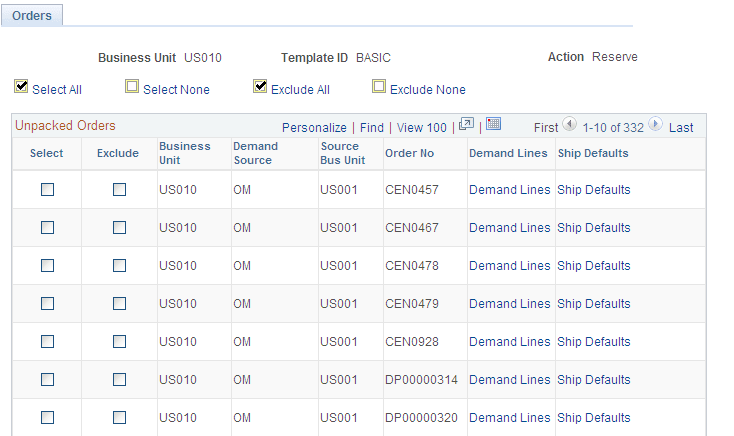

Orders Page
Use the Orders page (IN_FW_ORDERPOOL) to view all of the material stock orders and sales orders matching the search criteria on the Fulfillment Workbench.
Also include or exclude specific orders.
Navigation:
Select the Orders link on the Fulfill Workbench page, the Demand Lines page, or the Fulfillment Queue.
This example illustrates the fields and controls on the Orders page of the Fulfillment Workbench. You can find definitions for the fields and controls later on this page.
The Unpacked Orders section displays all orders with unpacked quantities matching the search criteria entered on the Fulfillment Workbench page. These orders appear by business unit, demand source, source business unit, and order number.
Select
Check to include this order in the request.
Exclude
Select to define the search criteria as exclusion criteria. This check box appears only if Detail is selected in the Search By field. Selection criteria entered are used to exclude demand data from the group. For example, if you want to pick confirm all the orders in a pick batch ID except order number 55, then enter the pick batch ID at the group level and add the group segment to the fulfillment queue. Next, bring up the detail selection information by entering Detail in the Search By field and selecting the Exclude check box. Then enter the pick batch ID and order number 55. Add the detail segment to the fulfillment queue. Then use the Fulfillment Queue link to review the transaction request and write it to the staging tables when you click the Process button.
Note: If the Exclude check box is selected at the order or demand line level, then that order or demand line must exist in the selection criteria established at the group level. If it is not in the selection criteria, then the fulfillment engine rejects the transaction request.
Demand Lines
Select to access the Demand Lines page, where you can view the demand lines associated with this order number.
Ship Defaults
Select to access the Picking/Shipping Overrides page where you can override the picking storage location and shipping parameters. The overrides entered through this link apply only to the order selected.
Complete Flag
Choose a Complete Flag option to automatically perform picking feedback functionality on demand lines that have not been marked for confirmations. The LLS segment and the override location are applied prior to implementing the complete flag logic. The Complete Flag options are:
  • Complete Pick - Dft Sh Loc: Uses the default shipping location as the pick location for demand lines that do not already have the Confirm Flag set.
    The default shipping location is stored at both the business unit and business unit/item levels.
  • Complete Pick - Leave Alone: With this option any lines within the selection criteria that do not have the Confirm Flag set are left alone.
    The Confirm Flag is not set on these demand lines.
  • Complete Pick - Zero Quantity: Sets the zero picked flag for every line within the selection criteria if they do not already have the Confirm Flag set.
    Also removes and deallocates any current allocations.
  • Pick Batch Complete: Removes every line within the selection criteria from the pick batch ID if they do not already have the Confirm Flag set.
  • Pick Batch as Planned: Sets the Confirm Flag on any line that has had picking activity.
    In this situation picking activity is assumed to be satisfied if there are any allocations as well as if the demand line is a zero picked demand line. An error is generated for any lines that have not had any picking activity when using this option.
  • Pick Line Complete: Removes the line from the pick batch ID if the Confirm Flag is not already set.
    It is only valid when referencing an individual pick/batch line at the group or detail level.
  • Pick Line as Planned: Sets the Confirm Flag on any line that has had picking activity.
    In this situation picking activity is assumed to be satisfied if there are any allocations as well as if the demand line is a zero picked demand line. An error is generated for any lines that have not had any picking activity when using this option. This option is only valid when referencing a pick/batch line at the group or detail level.
  • Use Defaults: Select to have the system use the Complete Flag option defined for the Fulfillment Workbench-Request Picking Feedback line on the Setup Fulfillment-Fulfillment Task Options page (business unit level).
    If no value is entered, then use the value in the Fulfillment Engine Options page (SetID level).
Note: For fulfillment engine transaction requests, the level (header, group or detail) where the Complete Flag is located determines what level to apply the complete flag logic.
