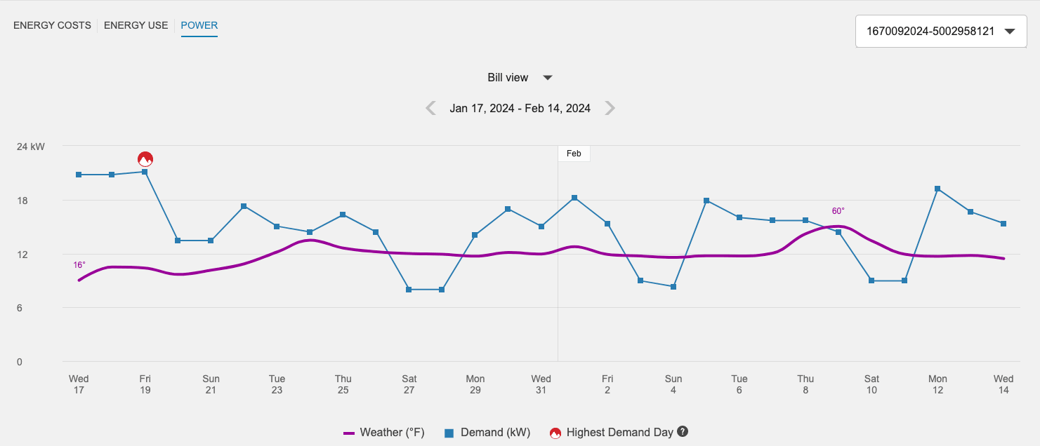

Bill View Example
Screenshot of the Bill level view of the Power chart.

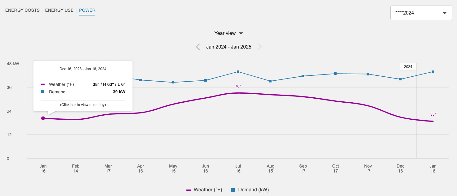

Year View Example
Screenshot of the Year level view of the Power chart.
