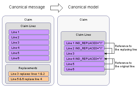

Bundled and un-bundled claim lines cannot be processed:
The original claim line or replaced claim line holds a reference to a non-existing claim line code number (CLA-IP-CLAI-005);
A claim line code is part of more than one bundling or un-bundling or replaces itself (CLA-IP-CLAI-006)

Replaced Lines
The request message specifies which claim lines will be replaced by which other claim lines. In the data model, each claims line directly references either the line that it replaces or the line by which it is replaced (only 1-to-n and n-to-1 replacements will be allowed). The claim line replacement taken into account the values of the element originalClaimLine and replacementClaimLine on the claim line
Consider a sample message:
<claim>
<claimLineList>
<Claimline code="1"
replacementClaimLineCode ='3'/>
<Claimline code="2"
</Claimline>
<Claimline code="3"
</Claimline>
<Claimline code="4"
<Claimline code="5"
originalClaimLineCode ="4"/>
</Claimline >
<Claimline code="6"
</Claimline>
</claimLineList>
</claim>
The message reflects a claim with lines 1 through 6, where line 1 and 2 is replaced by line 3, and line 5 and 6 replaces line 4. The resulting claim line references:
