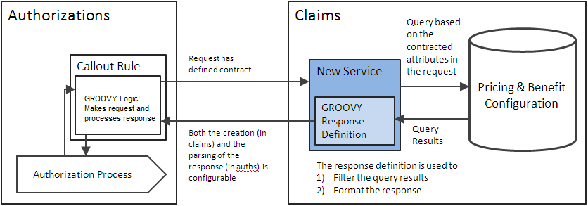

Claims Advice Service is a REST based API exposed by Claims to check if a specific medical service is contracted and/or covered based on the configuration in Claims, without processing an actual claim.
The path where this service be available will be:
http://<HOST_ADDRESS>:<HOST:PORT>/<CONTEXT_ROOT>/claimsadviceservice
The service will expose a POST method. "adviceResponseDefinitionCode" can be passed in as a Accept Header parameter to specify which dynamic logic on the claims side should be picked up to create the response. If there is no header parameter passed in, a default definition is picked up. In case no defaults are defined, an error message is given back with status code 406 (Not Acceptable).

The return type of the service will be a structure returned by the dynamic logic. It can be a XML/JSON or a plain string depending upon the dynamic logic construction.
AdviceService Selection Logic
Benefits
The advice service will perform a fixed query based on the input parameters to fetch product benefit specifications. It will perform the selection for Coverage, Waiting Period and Authorization type of Product Benefit Specification. The following considerations will be taken:

No validations will be made or exceptions will be raised if multiple product benefit specifications are found with same priority.
The result of the selection will be a Map of selected ProductBenefitSpecifications based on the type of the specification:
"WaitingPeriod" : List<ProductBenefitSpecification>, "Authorization" : List<ProductBenefitSpecification>, "Coverage" : List<ProductBenefitSpecification>
