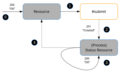

From a high level this use case can be visualized by the following diagram.
Let’s go over the various elements in this diagram:
This shows an initial stage of a Claim resource that was returned from some prior interaction at 0.
The server has embedded the link relation for claim:submit, with which a consumer of the API can interact with at 1.
The server acknowledges this submission with a HTTP 201 (Created) message and sets a HTTP Location header to the Status resource at 2.
The Status resource can subsequently be refreshed (i.e. polled for) to track progress at 3 by a consumer of the API. A consumer can interrogate the Status resource’s mandatory "completed" attribute to find out whether it is (still) useful to refresh the Status resource.
Note that the Status resource will have a link relation of rel="related" to identify the related resource that was affected by a completed process - see 4.
In case of processing errors - i.e. "progress" attribute failed - the Status resource contains an error property, which provides the detail of the issue(s).
