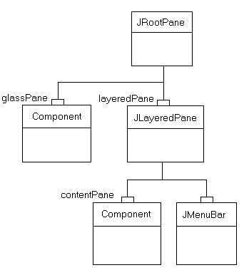

The following image shows the relationships between the classes that use root panes.
The following text describes this graphic.

the following text describes this graphic.
The diagram at right shows the structure of a JRootPane. A JRootpane is made up of a glassPane, an optional menuBar, and a contentPane. (The JLayeredPane manages the menuBar and the contentPane.) The glassPane sits over the top of everything, where it is in a position to intercept mouse movements. Since the glassPane (like the contentPane) can be an arbitrary component, it is also possible to set up the glassPane for drawing. Lines and images on the glassPane can then range over the frames underneath without being limited by their boundaries.
Although the menuBar component is optional, the layeredPane, contentPane, and glassPane always exist. Attempting to set them to null generates an exception.
