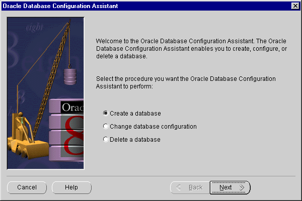

  1. Choose Start > Programs > Oracle - HOME_NAME > Database Administration > Database Configuration Assistant.
    The Oracle Database Configuration Assistant Welcome page appears.

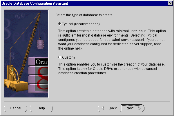

  2. Select Create a database, then click Next.
    The following page appears:
    Option  Description
    Typical
    Consists of two suboptions:
    • Copy existing database files from the CD
      Automatically installs a Hybrid starter database with the default initialization parameter settings
    • Create new database files
      Asks you several database environment questions before dynamically creating a database
    Custom
    Enables you to customize the creation of your database. This option is only for Oracle database administrators (DBAs) experienced with advanced database creation procedures, such as customizing:
    • Data, control, and redo log file settings
    • Tablespace sizes
    • Extent sizes
    • Database memory parameters
    • Archiving formats and destinations
    • Trace file destinations
    • Character set values
  3. Choose the Typical or Custom option to create a database:
    Both the Typical option (through its Create new database files suboption) and the Custom option enable you to specify the type of environment in which to operate your Oracle8i database:
