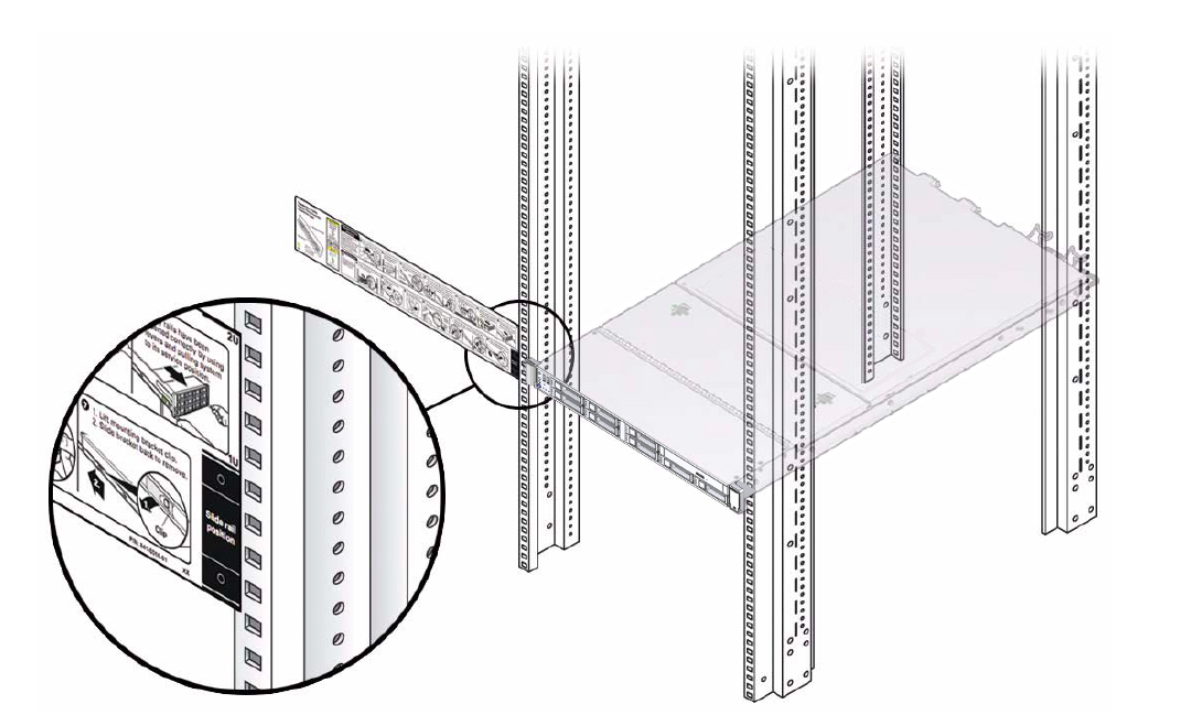

Mark the Rackmount Location
Use the rackmount installation card to identify the correct mounting holes for the slide-rails.
Note -  Load the rack from bottom to top.
  1. Ensure that there is at least 1 rack unit (1U) of vertical space in the rack cabinet to install the controller.
    See Rack Requirements.
  2. Place the rackmount installation card against the front rails.
    The bottom edge of the card corresponds to the bottom edge of the controller. Measure up from the bottom of the installation card.
    image:Figure showing the installation card being used for rackmount                             location.
  3. Mark the mounting holes for the front slide-rails.
  4. Mark the mounting holes for the rear slide-rails.
