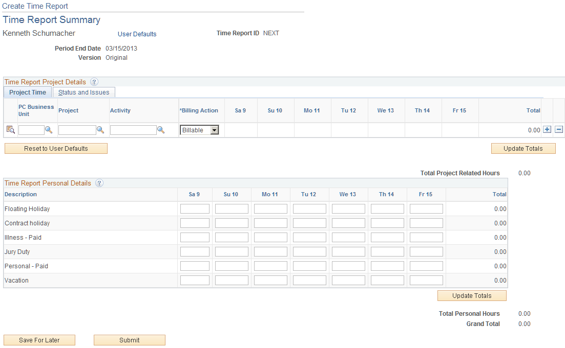

Time Report Summary Page
Use the Time Report Summary page (TE_TIME_LINES) to enter current and future project and personal time.
Navigation:
This example illustrates the fields and controls on the Time Report Summary page when the Disable Entry of Future Project Hours option is selected on the Expenses Definition – Business Unit 2 page.
When you select the Disable Entry of Future Project Hours check box on the Expenses Definition – Business Unit 2 page, PeopleSoft Expenses prevents employees in the business unit from entering future time on their time reports. PeopleSoft Expenses disables the future days in the project time entry grid.
If you select the Disable Future Entry check box for a time reporting code on the Time Reporting Code (EX_TRC_EX and EX_TRC_MAP_TBL) pages, PeopleSoft Expenses prohibits employees from entering personal hours on a time report if the date entered on the report is after the current date.
As displayed in the page shot above for a time report with a period end date of August 28, 2009, Kenneth Schumacher can only enter project time for the current date, August 27, 2009. In the personal grid, PeopleSoft Expenses enables him to enter vacation time for Friday the 28th; however, PeopleSoft Expenses does not enable Kenneth Schumacher to enter future time for illness.

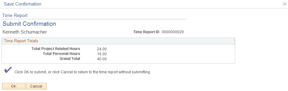

Submit Confirmation Page
Use the Submit Confirmation page (TE_SUBMIT_CONFIRM) to enter an explanation as to why you are submitting the time report late or made changes.
Navigation:
Click the Submit button on the Time Report Summary page.
This example illustrates the fields and controls on the Submit Confirmation page. You can find definitions for the fields and controls later on this page.
When employees submit time reports late or enter changes after the cutoff date, PeopleSoft Expenses prompts them to enter an explanation as to why they are late or made changes.
