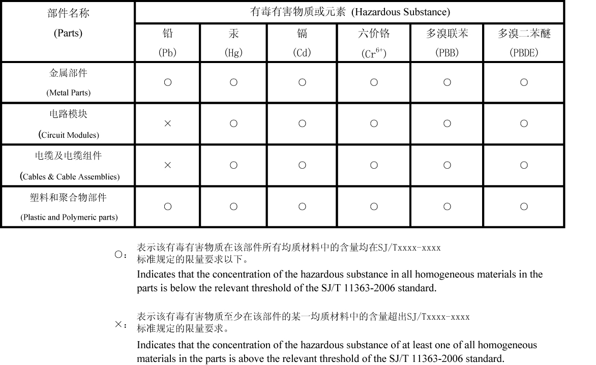

- Relevent standards in SJ/T 11363-2006 for limits of certain hazardous
substances.
Figure 1-3 Hazardous Substances
