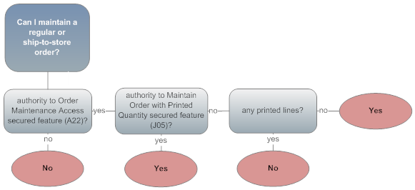

Maintaining a regular or ship-for-pickup order: The following chart summarizes the authority required to maintain a regular or ship-for-pickup order:

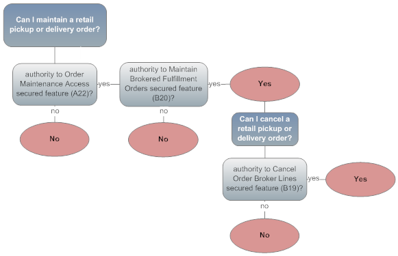

Maintaining a retail pickup or delivery order: The following chart summarizes the authority required to maintain or cancel a retail pickup or delivery order:

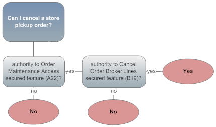

Canceling a store pickup order: The only possible maintenance of a store pickup order is to cancel it. The following chart summarizes the required authority.

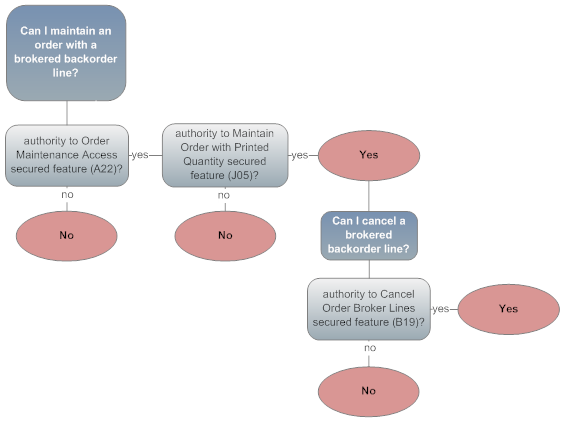

Maintaining an order that includes any brokered backorder lines: The following chart summarizes the authority required to maintain an order that includes any brokered backorder lines:

- If you select a store pickup order, the only available option is to cancel the entire order, provided you have sufficient authority. See Store Pickup Orders for an overview, and see Canceling a Store Pickup Order for details.

Maintaining Retail Pickup or Delivery Orders from Order Orchestration
If you have authority under the Maintain Brokered Fulfillment Orders (B20) secured feature, a window displays a warning message when you select an open or held delivery or retail pickup order for maintenance, indicating that maintenance options are limited.
Secured feature: If you do not have authority under the Maintain Brokered Fulfillment Orders (B20) secured feature, you cannot maintain a delivery or retail pickup order received from Order Orchestration.
Possible updates: You might need to maintain a retail pickup or delivery order to:
- Sell out an item that is no longer available: Order Administration sends a reject request to Order Orchestration. Order Orchestration then attempts to find another location to fulfill the order unless the order has already reached the Search retries maximum specified in Order Orchestration.
- Cancel an item that the customer no longer wants: Order Administration sends a cancel request to Order Orchestration, indicating that the order should not be fulfilled. Order Orchestration does not reassign a canceled order to another fulfilling location.

Restrictions on changing an order line: You cannot:
- Update an item in any way if a pick slip has been printed. You must void and reprint the pick; see Reprinting and Voiding Pick Slips (WVRP or WSVP).
- Change an item if shipments have been made against the line or the line has been canceled.

- You cannot cancel an item if a pick slip has been printed for that item. Instead, you must first void the pick slip. See Reprinting and Voiding Pick Slips (WVRP or WSVP).

Retail pickup and delivery orders: If you cancel an item on a retail pickup or delivery order, the system changes the Order Orchestration record’s status to Canceled and sends a status inquiry request to Order Orchestration. If the order’s status in Order Orchestration is:
- Canceled: the system does not send a status update to Order Orchestration; otherwise,
- If the order’s status in Order Orchestration is anything but Canceled, the system sends a status update to Order Orchestration indicating the status is Rejected. In this situation, Order Orchestration then changes the order status to New_order.

Canceling brokered orders: You need authority under the Cancel Order Broker Lines (B19) secured feature to cancel a retail pickup, delivery, or store pickup order, or an order that includes a brokered backorder line. For an overview, see Order Orchestration Integration, including:
- Canceling a Brokered Backorder Request
- Retail Pickup (including Ship-for-Pickup) or Delivery Orders
- Canceling a Store Pickup Order
