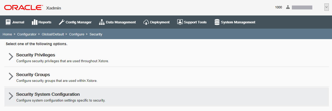

  1. Select an option from the Security Configuration page:
    Figure 5-41 Security Configuration Page Options
    • Select Security Privileges to set up Oracle Retail Xstore Point-of-Service security privileges. Continue with step 2 below.
    • Select Security Groups to add or edit existing Oracle Retail Xstore Point-of- Service security groups. Skip to Security Groups Setup.
      Select Security System Configuration to configure system configuration settings specific to security. Skip to Security System Configuration.

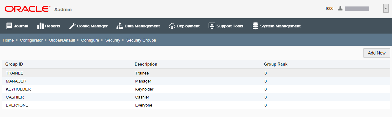

  2. You have the following options at the Security Groups Page:
    Figure 5-44 Security Groups Page
    Security Groups page
    • To add a new Security Group, click the Add a new security group link.
