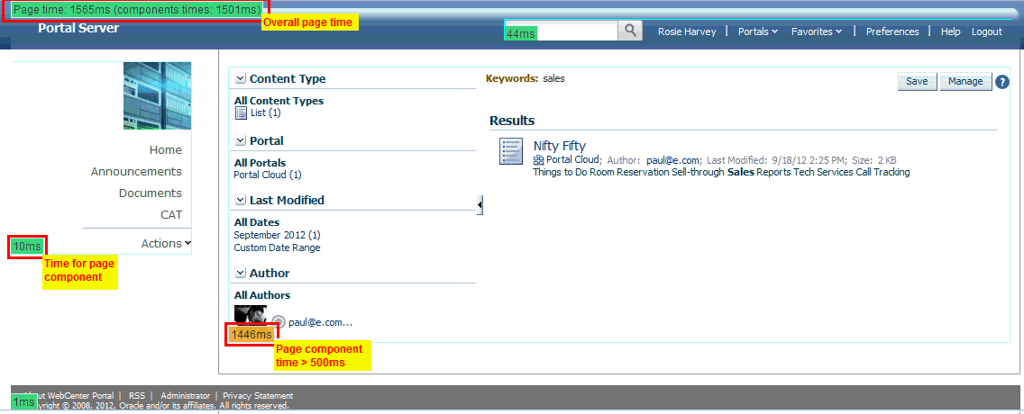

Use WebCenter Portal’s page performance analyzer to quickly see how long individual components take to display on a portal page, as well as the overall time taken to display a page. When enabled, this tool dynamically measures and presents the performance of individual page components whenever you display a portal page.
The portal page performance analyzer is useful to developers who are performing first level performance analysis, customers who build their own pages, and any user who customizes pages in WebCenter Portal.
This section includes the following subsections:
About the Portal Page Performance Analyzer
The portal page analyzer offers a simple way to diagnose slow pages and requires minimal set up or configuration. When this feature is on, the time spent on “high level” page components is calculated and displayed so you can see at a glance which components are slowing down your page. The overall time spent on the page also displays at the top left of the page (see Figure 1).
About Page Component Timings
In WebCenter Portal, “high level” page components are wrapped in a ShowDetailFrame so they can be moved, hidden or shown on the page, and edited by Oracle Composer and it is the overall timing for each ShowDetailFrame that displays.
About Overall Page Time
The overall page time is the sum of the individual page component timings, plus some additional processing time for page-level operations such as session replication, save and restore page state, page level security checks, and so on. For more consistent results, refresh the pages by clicking through the testing pages before enabling Page Performance Analysis.
Color Coding
Performance timings display in various colors to help alert you to problem areas. Refer to the following table:
Color Time to Display
Green
< 100 ms
Green/Yellow
100 - 500 ms
Yellow
500 ms - 1 second
Orange
1 - 3 seconds
Red
> 3 seconds

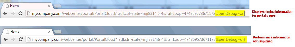

Displaying and Hiding Page Timing Information for Your Current Session
When an administrator enables the page performance analyzer in an WebCenter Portal instance, anyone with access to that WebCenter Portal instance can elect to display or hide page timing information, for their current user session, by appending the perfDebug parameter to the page URL as follows:
To... Add a perfDebug parameter to the page URL
Display timing information on portal pages
&perfDebug=on
Stop displaying page performance information
&perfDebug=off
To display timing information on portal pages:
  1. Verify that your administrator enabled the page performance analyzer in your WebCenter Portal instance.
    See also Enabling and Disabling Portal Page Performance Analysis.
  2. Log in to WebCenter Portal and navigate to the portal page that you want to investigate.
    You do not need to log in if the page is a public page.
  3. Add &perfDebug=on to the end of the page URL (Figure 2).
    For example:
    http://mycompany.com/webcenter/portal/MySalesPortal?_adf.ctrl-state=mji8314i6_4&_afrLoop=474789135539036&perfDebug=on
  4. Click “Go” or press Enter to redisplay the page with timing information (as shown in Figure 1).
    All subsequent pages that you display show timing information as well.
To stop displaying page timing information:
  1. In your browser, add &perfDebug=on to the end of any page URL (Figure 2).
    For example:
    http://mycompany.com/webcenter/portal/MySalesPortal?_adf.ctrl-state=mji8314i6_4&_afrLoop=474789135539036**&perfDebug=off**
  2. Click “Go” or press Enter to display the page again without timing information.

    Alternatively, use Fusion Middleware Control to proactively identify the slowest pages in your application. See How to Identify Slow Pages.
  2. Append &perfDebug=on to the page URL to display timing information for the page.
    See also, Displaying and Hiding Page Timing Information for Your Current Session.
    Note: If page timing information does not display, ask your administrator to enable the page performance analyzer. For details, see Enabling and Disabling Portal Page Performance Analysis.
  3. Identify the slowest page components, and troubleshoot the issue further:
    For example, if the slow component contains:
    • Document, wiki, or content presenter, check the performance of the back-end Content Server and the database that Content Server is using.
    • Activity stream, use AWR reports to check database performance and to see if you can tune the database table used by activity stream.
    • Collaboration features, check the performance of the associated back-end server. For example, for announcements or discussions, monitor the performance of the discussions server.
    • Portlets, use Fusion Middleware Control to monitor portlet request timing information, errors, portlet producer performance, and so on
  4. If necessary, add the slow page component to a separate “blank” page and then do further profiling.

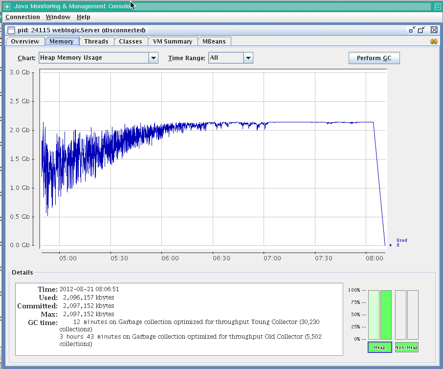

Troubleshooting Memory Leaks and Heap Usage Problems
If WebCenter Portal performance degrades over time, heap usage and garbage collection activity is increasing, and you see OutOfMemoryErrors, there could be memory leaks in the application causing the amount of free memory in the JVM to continuously decrease.
To solve this problem:
  1. Determine the cause of OutOfMemoryErrors errors:
    • Review the server_name.out file for OutOfMemoryErrors errors.
      The server_name.out file is located at:
      (UNIX) DOMAIN_HOME/servers/server_name/logs
      (Windows) DOMAIN_HOME\servers\server_name\logs
    • Take a memory dump when OutOfMemoryErrors errors occur.
      For example:
      On Sun HotSpot: jmap -dump:live,format=b,file=<path>/heap.hprof <pid>
      OnJRockit: jrcmd <pid> hprofdump filename=<path>/heap.hprof
      You can configure JRockit to automatically generate a heap dump in HPROF binary format (.hprof file) each time an OutOfMemoryErrors occurs, by setting the JRockit JVM option, -XX:+HeapDumpOnOutOfMemoryError.
  2. Restart the managed server.
    If the problem persists, proceed to Step 3.
  3. Open the heap.hprof file with a heap-dump analysis tool that can handle binary HPROF format, such as Eclipse Memory Analyzer.
  4. Determine which objects and classes are retaining the most memory.
  5. If necessary, take several heap dumps to determine which objects or classes are consuming and increasing the amount of memory.
    Take at least two memory dumps:
    • Take the first dump when the system is warmed up and stabilized.
    • Take the second dump, when the system is about to run out of memory, that is, full garbage collection gets less than 300MB from the maximum heap size.
    Instructions on how to take a heap dump using Sun HotSpot (jmap) or JRockit (jcrcmd) is described in step 1.
    Many heap dump analysis tools, such as Eclipse Memory Analyzer, enable you to compare two heap dumps to identify memory growth areas.
    Heap dumps provide information on why memory is retained (Retained Heap). Sometimes it is necessary to know how memory is allocated to further resolve the issue. For these cases, proceed to Step 6.
  6. Use the JRockit Memory Leak Detector tool that is part of JRockit Mission Control Client to understand how memory is allocated.

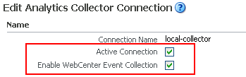

Troubleshooting Issues with Analytics
Problem
If users cannot see analytics in WebCenter Portal, verify the following:
Solution

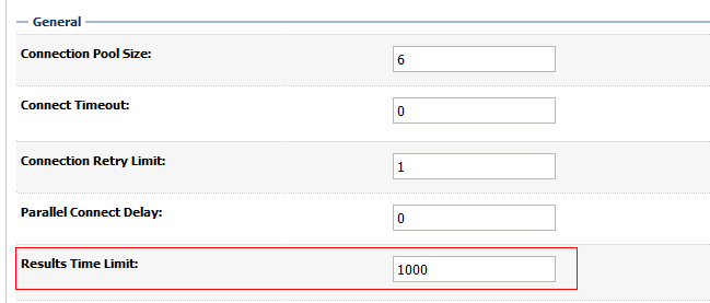

Profile Crawling Fails with 401 Error
Problem
Profile crawling is a part of portal crawling and happens in batches. Sometimes one of the batches fails with 401 errors which can be observed in the diagnostic logs. You see the following kind of error logs:
Crawl failed for service
oracle.webcenter.peopleconnections.profile using crawl url
 http://host:port/rsscrawl?context=&startIndex=77000&serviceId=oracle.webcenter.peopleconnections.profile&command=GetData&jsonFormat with status 401
Solution
This issue appears when the service times out on the client-side. Increase the Results Time Limit value for the LDAP authentication provider in the WebLogic server console.
One of the reasons to see a 401 intermittently is due to LDAP client timeout issue. To determine if the reason is LDAP client timeout issue, do the following:
  1. Log in to the WebLogic Server Administration Console.
  2. Navigate to the managed server on which WebCenter Portal is deployed. Select Environmentthen, Servers, and then select the WebCenter Portal instance (WC_Portal).
  3. Open the Debug tab, and expand weblogic, then security, and then atn.
  4. Select the authentication logger that you want to enable and click Enable.
  5. Schedule a crawl again. See Manually Starting a Full Crawl.
    This time you are expected to see a lot more debug logs in WC_Portal.log.
Around the time stamp you can see 401 in portal diagnostic log, check for server debug logs in WC_Portal.log and check if you see the following kind of error logs:
<weblogic.security.providers.authentication.LDAPAtnLoginModuleImpl.loginexception:java.security.PrivilegedActionException:weblogic.security.providers.authentication.LoginServerUnavailableException:Time to complete operation exceeded
This confirms that it is a client-side timeout issue. To rectify this, increase the Results Time Limit  value for the LDAP authentication provider in the WebLogic server console.
To update the Results Time Limit  value:
  2. From the Domain Structure pane, click Security Realms. The Summary of Security Realms pane displays.
  3. Click your security realm. The Settings page for the security realm displays.
  4. Open the Providers tab and select the LDAP authentication provider you are configuring.
  5. Open Provider Specific tab and verify if the Results Time Limit is set to some value, other than 0.
    This screenshot shows the Resukt Time Value.
  6. Increase the Results Time Limit value and click Save.
  7. Restart WebLogic Server for the changes to take effect.
  8. schedule a crawl again. See Manually Starting a Full Crawl.
