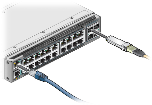

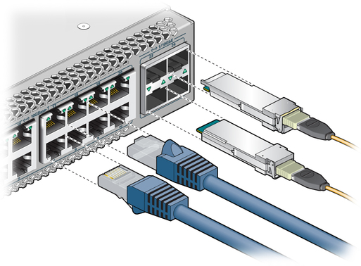

Note - This procedure primarily describes attaching data cables, however the procedure is the same for the management cables.
The shell should not be bent and should be parallel to the inner boards. If the connector is bent or damaged, use a different cable.
Upper row - Connector tab is up.
Lower row - Connector tab is down.

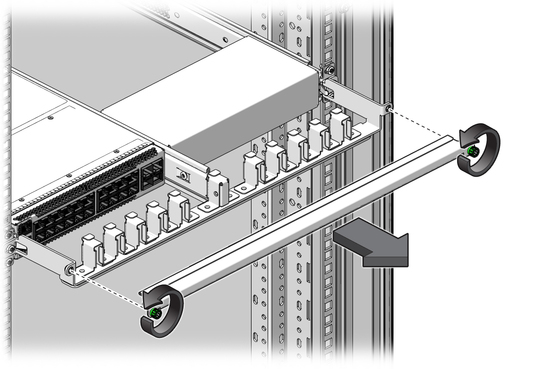

If you are installing the switch with the data connectors on the hot aisle, go to Step 12.
If you are installing the switch with the data connectors on the cold aisle, return to Prepare the Front Support and Small Air Duct.

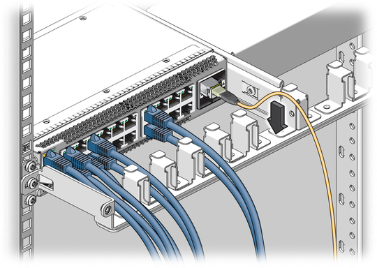

Four cables fit into each slot in the CMA.
