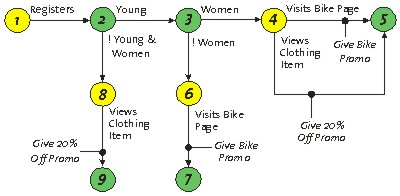

The state machine for our promotion example can be described as follows. An SSM has two kinds of states: waiting (shown in yellow) and intermediate (green). Waiting states are where the scenario execution must stop in order to wait for the next event (or several events, as is the case with state 4 below).
This diagram is described in preceding text
Intermediate states are used to channel users to different paths through the state machine. For instance, users who arrive at state 2 in the example proceed to either state 3 or state 8, depending on whether they are young or old and female (old males don’t proceed beyond state 2, since there is no transition for them to take). Note that the conditions (or filters) leading out of the intermediate state are always mutually exclusive; thus, any individual user follows a single linear path through the SSM. Scenario actions take place as part of the SSM transitions; for example, a user is given a bike promotion as part of the transition from state 4 to state 5, and so on.
