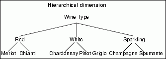

The following figure illustrates a typical dimension:
Child dimension values enable users to refine their navigation queries and, consequently, the resulting record sets. Thus, when you configure dimensions, make sure that child dimension values contain more specialized data than their parents. See Refining a navigation query in a hierarchical dimension for more information about query refinements.

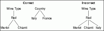

A dimension value can have only one parent dimension value but any number of child dimension values.
In the example on the left below, Red is the child of the Wine Type dimension value and the parent of the Merlot and Chianti dimension values. The example on the right is incorrect, because Red is specified as the child of both the Wine Type and Flavor dimension values. An Endeca dimension value can have only one parent.

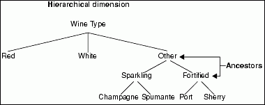

The ancestors of a given dimension value are all the dimension values between the given dimension value and the dimension root. The parent of the given dimension value is also one of its ancestors.
In the example below, Other and Fortified represent the ancestors for the Sherry dimension value.

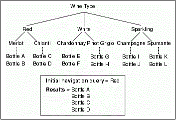

The MDEX Engine returns not only the records tagged with the dimension value to which you navigated, but also those records that are tagged with any of that dimension value’s children.
In the following example, a navigation query on Red would produce a result set of four bottles, Bottles A through D.

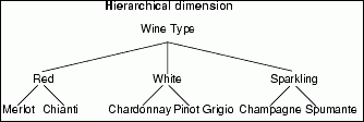

For example, in the flat dimension below, a navigation query on the Wine Type dimension value would return six possible refinement queries, one for each child.
A simple flat dimension such as the one shown in the preceding figure is small enough to navigate through quickly. Larger flat dimensions, however, present too many choices for follow-on queries to be easily navigable.
Organizing data as dimensions reduces this information overload and provides for an easier, more intuitive navigation experience. In the hierarchical example below, the Wine Type dimension value has only three possible refinement queries: Red, White, or Sparkling.

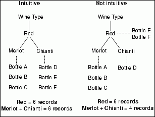

While it is technically possible to tag your Endeca records with any dimension value that exists in a dimension, it is highly recommended that you tag your Endeca records only with leaf dimension values. The following figure illustrates leaf dimension values in a simple dimension.
Tagging your Endeca records with leaf dimension values creates a more easily understood navigation experience, because the sum of the records in the leaf dimension values equals the number of records returned for the parent dimension value.
The following figure illustrates the difference between tagging all records with leaf dimension values and tagging some records with dimension values that are not leaves:
As the preceding figure shows, tagging all records with either of the two leaf values Merlot or Chianti produces the same result set for the query on "Red" and the query on "Merlot + Chianti". However, tagging two of the records (Bottle E and Bottle F) with a non-leaf dimension value ("Red") produces different result sets for the query on "Red" and the query on "Merlot + Chianti".
