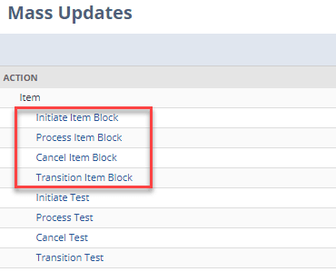

For each record type, the Mass Updates page lists the workflows that you can initiate, process, cancel, or transition. For example, the following screenshot shows that there are two workflows based on the Item record:
Item Block
Test
