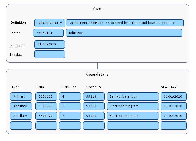

Adjudication Case
The results of the recognition of a case are stored in the adjudication case and adjudication case detail entities. An adjudication case is a group of claim lines that belong to the same episode of care.

For each case definition, Claims will keep track of the regime and limit counters. Case regime counters are used to determine which tranche to apply in a case based regime. Case limit counters are used to keep track of monetary or numbers limits on the regime, for example, a maximum copay per case
The start date of a case is determined when the case is first recognized. This is done by executing the start dynamic logic function of the case definition whenever the case is stored during claims processing. Alternatively, a case plus primary claim line can come in through the Case Integration Point; in this instance, the start date should be provided for by the IP.
The end date of a case can be determined in four ways
  • When the case is first recognized. The end dynamic function is executed when the case is first recognized. This is done using the primary claim line as the triggering line. This implies that the logic in the end dynamic function is executed using the data of the primary line. If the end date is not determined by the primary line the end dynamic function returns an empty result instead of a date.
  • When an ancillary line is recognized. The end dynamic function is executed for each ancillary line that is included in the case. If the end date is determined by an ancillary line then the end dynamic function must return the end date.
  • When a new case is recognized for the same person or object and with the same case definition. The "old" case is then ended at the day before the start date of the new case.
  • When the end date is provided for through the Case Integration Point.
The option to void a adjudication case supports remediation in the situation where an existing adjudication case is in conflict with the adjudication cases created by other claims, such as a time overlap. A voided adjudication case is ignored in claims processing. This means the adjudication case does not raise time overlap violations, nor is it available when the system considers adding ancillary claims.
Adjudication Case Details
This entity is a crosswalk between claim lines and the case in which they are included a either primary or ancillary line.
