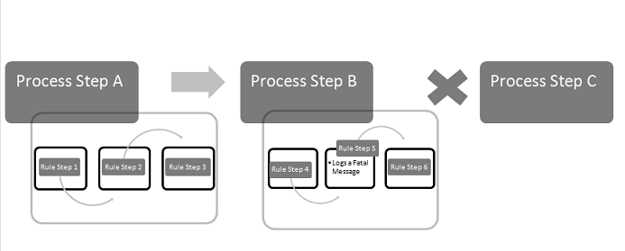

Process Step and Fatal Message
Rule Steps
During processing of a process step - the callout and validation rules are evaluated, based on the configured execution order (sequence). A rule step is not evaluated when the indicator enabled on the rule is set to 'No'.
The execution of a rule must be completed successfully (i.e. without a technical error) before the next rule (this can be a callout rule or a validation rule) is executed. If a technical error occurs in a rule step, the status of the Eligibility Check is set to Error and the eligibility check stops.
