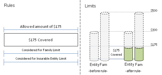

Counting Towards Limits
A variety of limits (also referred to as accumulators) can be set up in the system. Each limit has its own behavior in terms of renewal, carry over, individual or family, and so on. Limit is described in Adjudication Limits.
Limits can be connected to the liability calculation in a number of ways. One of them is by connecting limits to specific cover withhold rules in what are called "Count Towards Limit" records. The feature that is next described has been deprecated. The recommended way to configure accumulation is by creating product benefit specification limits.
Count Towards Limit
Field Description
Cover withhold rule
The cover withhold rule of which the result will count towards the specified limit.
Reached action
Specifies what should happen once the specified limit has been reached:
<stop>
In the event of a cover limit, the limit excess should be withheld, in the event of a withhold limit, the limit excess should be covered
<continue>
The rule contributes towards the limit, but reaching the limit has no impact on the cover withhold rule.
Limit
The limit towards which is counted.
Maximum Amount
The maximum amount against which the limit adjudicates
Maximum Amount Currency
The currency of the maximum amount; it is automatically set to the currency that is specified on the coverage regime.
Maximum Number of Units
The maximum number of units against which this limit adjudicates.
Maximum Service Days
The maximum number of distinct service days against which this limit adjudicates.
Limits may be counted in either amounts, distinct service days or number of units. It is not possible to let a single cover withhold rule count towards limits that have different types.

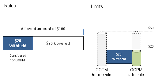

Consider the following scenario:
The product has a limit that represents a yearly maximum liability per person of $3000 across all benefits. This limit has the code <Out Of Pocket Max>.
Additionally, the payer has set up the following rule for specialist visits:
  1. <Withhold><20%> of the <original> amount, applied to the <original> amount as category <Coinsurance>.
    • Count the amount towards the <Out Of Pocket Max> and <stop> once the limit of <$3000> has been reached.
The payer receives a specialist visit claim line for $500 dollars. The current count for the out of pocket max is 2850 dollars. The resulting benefit specification states:
  • $500 Benefits input amount
  • $100 <Coinsurance withheld>
  • $400 <Amount after coinsurance>
  • $400 to be paid
  • This claim line consumed $100 of the <Out Of Pocket Max> limit, making the current count $2950
Note that Claims keeps track how much was consumed on one or more particular limits per claim line, as reflected by the last bullet. Now suppose the payer receives a second claim for $500. Because this claim causes the <Out Of Pocket Max> to be reached and exceeded, the resulting benefit specification is different from the previous:
The rule specifies 20% of $500 to be withheld, which amounts up to a $100 coinsurance. Before this result is applied, the $100 is counted towards the <out of pocket max>, but after only $50 the limit is reached. Because a <stop> action has been defined, only the first $50 is withheld, while the remaining $50 is not.
The results:
  • $50 <Coinsurance withheld>
  • $450 <Amount after coinsurance>
  • $450 to be paid
  • This service consumed $50 of the <Out Of Pocket Max> limit, making the current count $3000
The $450 <Amount after coinsurance> is the sum of the $400 remaining after the coinsurance, and the $50 that was not withheld as coinsurance due to the fact that the <Out Of Pocket Max> limit was reached.
In general - given that the reached action is <stop> - any amount in excess of a cover limit is labeled with the withhold label as specified by the cover withhold category of the cover withhold rule in question, and vice versa, any amount in excess of a withhold limit is labeled with the cover label as specified by the cover withhold category.
As stated before, it is possible for one cover withhold rule to count towards more than one limit simultaneously.

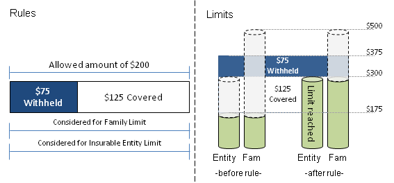

The payer keeps track of two limits: a person level deductible and a family level deductible. Both limits are consumed at the same time but as soon as one of them is reached, both limits are considered to be met. The payer also requires a 20% coinsurance that is applied before any deductibles.
  • Limit <Person Deductible>
  • Limit <Family Deductible>
The payer has set up a new cover withhold category for deductibles:
  • Category <Deductible>
    • Withhold label is <person and/or family deductible>
    • Cover label is <Amount after deductible>
The payer has set up the following rule for specialist visits:
  2. <Withhold><100%> of the <amount after coinsurance> applied to the <remaining covered> amount as category <Deductible>.
    • Count towards the <Person Deductible> and <stop> withholding once the limit of <$1500> is reached.
    • Count towards the <Family Deductible> and <stop> withholding once the limit of <$3000> is reached.
The current count for the person deductible is $1450.
The current count for the family deductible is $2910.
_A specialist visit claim line comes in for a benefits input amount of $200.
After processing of the first rule, the benefits input amount is split up into $40 coinsurance and a remaining amount of $160. Before the $160 is paid one of the deductibles must be fully consumed. Both limits are consumed at the same time but the <Person Deductible> is the first one to reach the limit, after $50. The result is the following specification:
  • $200 benefits input amount
  • $40 <Coinsurance withheld>
  • __$50 <Person and/or family deductible>
  • $110 <Amount after deductible>
  • $110 to be paid
  • This service consumed $50 of the <Person Deductible> limit, making the current count $1500
  • This service consumed $50 of the <Family Deductible> limit, making the current count $2960

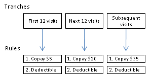

Reconsider the scenario of payer A, to clarify how tranches are configured. We disregard the deductible cover withhold rules to prevent the scenario from being needlessly complex.
Payer A sets up three tranches for doctor visits, each with its own (set of )cover withhold rules:
  1. Tranche with a maximum of <12> allowed units:
    • <Withhold><$5> applied to the <original> amount as category <Copay>.
  2. Tranche with a maximum of <12> allowed units:
    • <Withhold><$20> applied to the <original> amount as category <Copay>.
  3. Tranche without a maximum.
    • <Withhold><$35> applied to the <original> amount as category <Copay>.
A doctor visit claim line comes in for $100. The person had 16 prior doctor visits. This means that the second tranche is the current: 12 visits fell into the first tranche, and the 16th doctor visit represents the 4th visit in the 12 visits in the second tranche. Hence, a copay of $20 is applied.

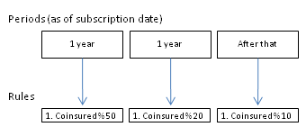

Let us consider the set up required for the scenario for payer A
Payer A sets up three coverage regime periods for orthodontic procedures, each with its own (set of )cover withhold rules. The subscription date is specified as the as-of date:
  1. Period of <1><year>
    • <Withhold><50%> of the <original> amount, applied to the <original> amount as category <Coinsurance>.
  2. Period of <1><year>
    • <Withhold><20%> of the <original> amount, applied to the <original> amount as category <Coinsurance>.
  3. Period of <unspecified length>
    • <Withhold><10%> of the <original> amount, applied to the <original> amount as category <Coinsurance>.
An orthodontic procedure claim line comes in for $140 with a service date on 11-MAY-2009. The person is subscribed to the product that provides the benefit since 03-MAY-2008. It is determined that the patient has been a subscribed person for 1 year and 8 days, qualifying the claim line for the second specified period. The cover withhold pertaining to this period specifies a 20% coinsurance, hence a copay of $28 is applied.

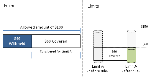

The payer has set up the following limit:
  • <Cover> limit <Limit A>
A <Cover> limit implies that something is covered up to the limit, and any limit excess is no longer covered. The payer has set up the following rule:
  1. <Cover><60%> of the <original> amount, applied to the <original> amount as category <Rule1>
    • Count towards <Limit A> and <Stop> at <$150>
A claim line for a benefits input amount of $100 is processed. The rule splits up the $100 into two amounts: $60 <Covered> and $40 <Withheld>. Because the rule is a cover rule, the amount covered is counted towards any pertaining limits. As a result only $90 ($150-$60) remains before <Limit A> is reached.
Coverage Regimes
The resulting claim line coverages:
  • $40 <Withheld>
  • $60 <Covered>

The payer has set up the following limits:
  • <Cover> limit <Family Limit>
  • <Cover> limit <Insurable Entity Limit>
  1. <Cover><100%> of the <original> amount, applied to the <original> amount as category <Rule1> .
    • Count towards <Family Limit> and <Stop> at <$500>
    • Count towards <Insurable Entity Limit> and <Stop> at <$300>
A first claim line for a benefits input amount of $175 is processed. The rule covers the full $175. Because the rule is a cover rule, the amount covered is counted towards any pertaining limits. As a result $175 counts towards both the <Family Limit> and the <Insurable Entity Limit>.
Coverage Regimes
Neither limit was reached - both the <Familiy Limit> and the <Insurable Entity Limit> have a current count of $125. So the first claim line results in the following claim line coverage:
  • $175 <Covered>
A second claim line for a benefits input amount of $200 is processed for the same person. The rule would cover the full $200, however, the is reached before that happens. Because only $125 remained in the insurable entity limit and the reached action is to 'stop', only $125 is covered. The $75 excess is not covered due to the fact that the exceeded limit is a cover limit.
Coverage Regimes
As a result of this claim line, the is fully consumed, but the <Family Limit> still has a remaining $200. The resulting claim line coverages:
  • $75 <Withheld>
  • $125 <Covered>
Now suppose a third claim line comes in, again for the same person, for a benefits input amount of $200. Normally the rule would cover the full $200, but because one of the limits has been reached and the reached action for that limit is 'stop', the full $200 is regarded as limit excess.
Coverage Regimes
The third claim line results in the following claim line coverage:
  • Withheld $200 <Withheld>
Note that because nothing is covered, the <Family Limit> is not counted towards either.
Finally, a fourth claim line comes in for a different person of the same family. The benefits input amount is $250. The for that person still has the full $300 remaining. However, the <Family Limit> only has a remaining $200. Normally the rule would cover the full $250, however, after the first $200 the <Family Limit> has been reached. Because the <Family Limit> is a cover limit and the reached action is 'Stop', the $50 excess is withheld even though the for that person has not been reached yet. The fourth claim line results in the following claim line coverages:
  • $50 <Withheld>
  • $200 <Covered>
Scenario B4
  • <Withhold> limit <Out of pocket max>
A <Withhold> limit implies that something is not covered up to the limit. Once the limit is reached, any excess amount is covered. The payer has set up the following rule:
  1. <Withhold><20%> of the <original> amount, applied to the <original> amount as category <Rule 1>.
    • Count towards <Out of pocket max> and <Stop> at <$50>
A claim line for a benefits input amount of $100 is processed. The rule splits up the $100 into two amounts: $20 <Withheld> and $80 <Covered>. Because the rule is a withhold rule, the amount withheld is counted towards any pertaining withhold limits. As a result only $30 ($50-$20) remains before the <Out of pocket max> (OOPM) is reached.
Coverage Regimes
Because the limit is not reached yet, the withhold rule processes as normal, resulting in the claim line coverages:
  • $20 <Withheld>
  • $80 <Coverage>

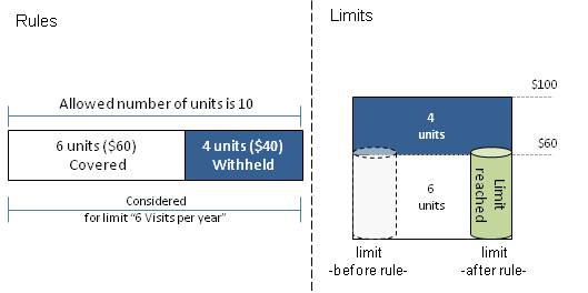

A claim line comes in with an allowed number of units of 10 for a total of $100. The number of allowed units is split up into two parts:
  • 6 units that fall within the limit. The benefits input amount that corresponds to the these 6 units is 6/10 of $100, being $60. Since the cover withhold rule specifies 100% coverage, $60 over 6 units are assigned to label <C1>
  • Remaining are the 4 units that exceed the limit: $40 over 4 units are assigned to label<W1>.
Coverage Regimes
The claim line results in the following claim line coverages:
  • $40 over 4 units as <W1>
  • $60 over 6 units as <C1>
  • 6 units that fall within the limit. The benefits input amount that corresponds to the these 6 units is 6/10 of $100, being $60. Since the cover withhold rule specifies 60% coverage, only $36 over 6 units are assigned to label <C1>
  • Remaining is:
    • The $40 due to the 4 units that are in excess of the limit.
    • The $24 due to the 6 units that were not fully covered.
Both the amount and number of units is summed up to determine the values assigned to the withhold label: $64 over 10 units are assigned to label <W1>.
Coverage Regimes
  • $64 over 10 units as <W1>
  • $36 over 6 units as <C1>
Note that this scenario presumes that a limit is used to keep track of the 6 visits per year. In the event that this limit is not used by any other regime, it makes more sense to set it up as a tranche of the regime rather than a limit. An alternative way to set up scenario B8 would be:
