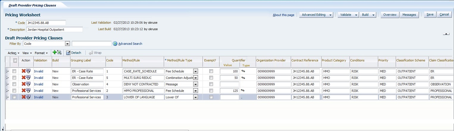

The task describes how to create new worksheets with draft provider pricing clauses and to edit existing draft provider pricing clauses on existing worksheets.
This page allows a user to edit draft provider pricing clauses in context of a single worksheet. There is another page that allows a user to edit draft provider pricing clauses across worksheets (refer to the text in []).
This page cannot be opened directly, but is opened through the "Pricing Worksheets" page (refer to the text in Pricing Worksheets, but read the text below first to understand the concept "Pricing Worksheet").

Pricing Worksheet
To create draft provider pricing clauses, first a worksheet has to be created as a container for the draft provider pricing clauses.
The decision on how to use worksheets, that is, to decide which draft provider pricing clauses should be put in which worksheet, is an implementation consideration. An imaginable use is that within a single worksheet all draft provider pricing clauses pertaining to the same contract reference are created and maintained. Another imaginable use is for a worksheet that contains all global draft provider pricing clauses, that is, those without a specific contract or provider reference.
After a worksheet code and description are entered in the master field, the draft provider pricing clauses for that worksheet can be created and maintained.

Buttons
The following special buttons display on the page header:
Validate (button with menu)
Validate Worksheet
Validate Selected Rows
Build (button with menu)
Build Worksheet
Build Selected Rows
Advanced Editing (button with menu)
Apply Option…
Apply Template…
Update Selected Rows…
Copy Selected Rows
Delete Selected Rows
Delete Worksheet

Total #
Valid #
Invalid #
Counters calculated during the last build run:
Created #
Updated #
Deleted #
Disabled #
- NOTE
The current counter on deletes shows the number of draft provider pricing clauses that have been deleted but were previously built. The corresponding real provider pricing clauses are deleted or disabled in the next build.
Messages
Clicking 'Messages' in the page header opens a dialog that shows all validation messages across all draft provider pricing clauses in the worksheet. These messages pinpoint the work that still needs to be done, for example, mandatory fields which need to be entered or configuration components (like procedure groups) that need to be created. Also, these messages can pinpoint business rule violations that need to be resolved.
The button 'Messages' is enabled only when at least one of the provider pricing clauses in the worksheet has a validation message. Directly following validation or build the button is enabled or disabled correspondingly.
The field that shows the validation status of a draft provider pricing clause features a click-able link, if that draft provider pricing clause has any validation messages. Clicking this link opens a messages popup showing only those validation messages specific to that draft provider pricing clause.
See below for an overview of all validation messages that may be raised.
