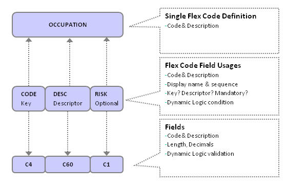

Flex Code Definitions
Consider the following image. It shows the configuration breakdown of a flex code definition and its flex codes. Flex codes are values that represent a domain. The purpose of such a domain is to bound the values of a dynamic field. A flex code is not (necessarily) a single value, that is, commonly a flex code is a record of several fields, each field with its own value. For example, a flex code can consist of a code and description field, as shown in the figure below. In this sense, a flex code definition is very similar to a table definition. The columns of the table are defined by flex code field usages. A flex code always keeps track of a start and end date, and the definition to which it belongs.
Note that the image reflects the setup for a flex code system that is used to specify a dynamic field. On the other hand, flex code systems that are used to specify procedure, diagnosis and provider codes do not have flex codes as values. Instead, these flex code systems are populated by the actual records in the procedure, diagnosis and provider tables.

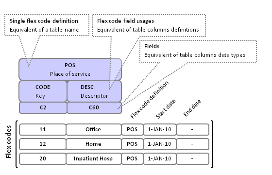

To clarify the purpose of the listed attributes consider the following scenario:
A payer wants to extend claim lines on professional claims with a field that captures the 'place of service' attribute. The payer intends to use a flex code system for this dynamic field. The payer sets up the following flex code definition:
Code: POS
Description: Place of service on professional claims
For each possible place of service, the payer stores two fields: the key, which is a two digit code, and a description, which is a 60 character field. For this purpose, the payer creates two flex fields:
Code: D2, Data type: char, Length: 2, condition: ONLY DIGITS
Code: C60, Data type: char, Length: 60
The condition ONLY DIGITS is a condition dynamic logic that enforces that only characters 0 through 9 are allowed. The reason why this field is specified as a character field rather than a number field is that only character fields are allowed to be used as flex code key fields. The last step is to specify the flex code fields, connecting the flex code definition with the flex fields. The payer creates the following two flex code field usages for the POS flex code definition:
Code: "pos", Display name: "PoS", Display sequence:0, Flex field:D2, Key?: checked, Mandatory?: checked.
Code: "description", Display name: "Description", Display sequence:1, Flex field:C60, Description?: checked, Mandatory?: checked.
The payer has now set up a complete definition. The next step is to setup the allowed values within this definition, that is, the flex codes.

The payer creates three new flex fields
Code 'C4', Description 'Generic text 4 chars', Length 4, Type 'Value', Data type 'Char'
Code 'C60', Description 'Generic text 60 chars', Length 60 Type 'Value', Data type 'Char'
Code 'C1, Description 'Generic text 1 char', Length 1, Type 'Value', Data type 'Char'
None of the value fields have a dynamic logic validation. None of the fields have a number of decimals.
Once the Fields have been set up, the next step is to specify how those fields are ordered to compose an 'occupation' flex code. The payer creates a flex code definition and a number of pertaining flex code field usages:
Code - This is the 'name' of the the Flex Code Definition. This code is used to reference this definition in other pages.
Description - A descriptive text to clarify the content of this definition.
A Flex Code Definition must have one or more flex code field usages. Each represents a column in the record that makes up the Flex Code. A Flex Code Field Usage has the following properties:
Field - This is the Field that specifies this 'column' of the Flex Code Definition.
Code - This is the name of the Flex Code Field Usage.
Display name - This is the column header in the Flex Code entry page.
Display sequence - The sequence of the column in the Flex Code entry page.
Key? - Indicates whether this Field is the key Field.
Descriptor? - Indicates whether this Field is the descriptor Field.
Mandatory? - Indicates whether this Field is a mandatory Field.
Allowable Values - Domain of possible values for this field.
Exactly one of the usages must represent the 'key' Field. The key field contains the unique identifier of a Flex Code, i.e., unique within the context of the Flex Code Definition. One of the usages may represent the 'descriptor' Field. The descriptor and key fields are displayed in user interface look-up tables.

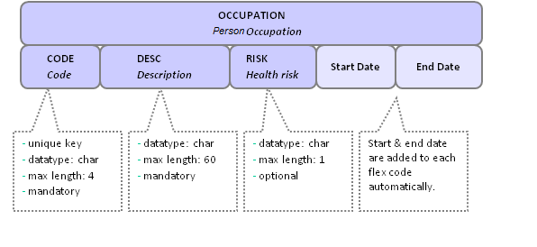

The payer starts by creating a new flex code definition. The payer specifies the code as 'OCCUPATIONS' and the description as 'Person occupations' .
An occupation flex code consist of three fields (code, description, and risk), so the payer creates three new flex code field usages:
Field 'C4', code 'CODE', display name 'Code'. Key field. Because key is checked this field defaults to mandatory, and the display sequence defaults to 0.
Field 'C60', code 'DESC', display name 'Description'. Descriptor field. The display sequence is set to 1.
Field 'C1', code 'RISK', display name 'Health risk' and we specify this field as optional. We set the display sequence to 2. The allowable values attribute refers to another flex code definition that only allows the values H (high) and L (low).
The result of our setup is that we have created a virtual table within Claims that has three columns. The next step is to populate that table.
Once the definition and field usages have been set up, the definition can be populated by Flex Codes. The properties of a flex code are exactly those fields that are defined in the pertaining flex code definition, plus a start and end date. So the properties of a flex code belonging to the OCCUPATION definition would have the following properties:
Occupation code - The identifying code by which this occupation is known. This code is used to reference this field in other pages.
Occupation description - A descriptive text of the occupation.
Occupation health risk - An indicator for the health risk involved for this occupation.
Start Date - The start date when this is a valid occupation
End Date - The last date on which this occupation is valid.
The payer enters the following flex codes for the OCCUPATION definition:

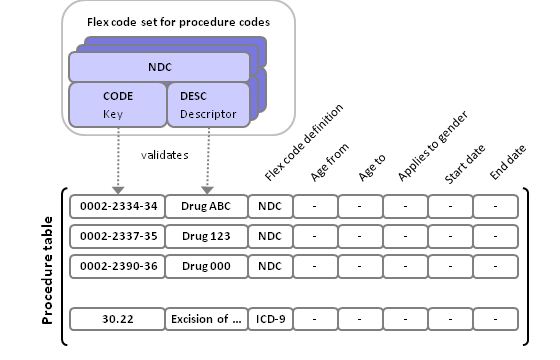

Scenario: specifying a code definition for Procedures
A flex code definition has one of two purposes: either it is set up to be used as a value domain for a dynamic field usage, or it is set up to serve a definition for diagnosis, procedure or provider codes.
The previous scenario covered the setup for a flex code definition used for a dynamic field usage. A flex code definition for a procedures, diagnoses or provider code system are essentially no different, with the exception that they validate procedure, diagnose or provider codes, instead of flex codes. This scenario covers only procedure codes, but the same holds true for diagnosis and provider codes.
Why does Claims use a flex code definition to specify procedure codes?
One payer may have to deal with multiple procedure code definitions. For example, the United States have different code definitions for the ICD-9, ICD-10, CPT and NDC procedures. It is quite possible that different procedure code definitions have overlapping codes, so it is imperative that each procedure code keeps track of the definition to which it belongs. For example, code 1234 may be a valid code in both the ICD-9 and ICD-10 procedure definition, but have a different meaning in either definition.
Using a flex code definition allows a user to extend a table with a dynamic field that holds a reference to an actual procedure, diagnosis or provider, rather than simply a code. For example, a payer can extend the claim line table with an 'admitting diagnosis' dynamic field. The set of allowable values for this field would then be derived from the diagnoses present in Claims.
Validating a procedure code by a through a flex code definition allows a payer to define a specific code format per definition. For example, it can be enforced that an ICD-9 code always consists of between 2 and 4 digits and that the second and third digit are always separated by a decimal point.
There are two peculiarities with regard to flex code definitions that specify a procedure code:
The definition only holds two fields: a key field for the code, and a descriptor field for the procedure description. Any additional flex code field usages are ignored by the system.
The Flex Code Definition is not linked to the Procedure through a Dynamic Field Usage. Instead, that Flex Code Definition is added to a dedicated Flex Code Set. Once a definition is added to this dedicated set it can automatically be used to define procedures. This dedicated Flex Code Set is specified during an Claims implementation.
The payer wants to set up a new flex code definition for the National Drug Code system (NDC). These NDC codes have a specific format. The code is composed of three sections. The first section specifies the product labeler, the second the product segment and the third the package segment.
Even though NDC codes are composed, the payer decides to use a flex code definition. The reason is that the meaning of the second and third code segments depend entirely on the first part of the code. Therefore, even though an NDC code is segmented, the parts cannot be used separately nor independently.

The payer adds the NDC flex code definition to the flex code set named PROCEDURES. By doing so, the NDC definition becomes one of the available definitions for a procedure code.
The image shows the result of the setup described in this scenario. Each procedure record keeps track of the flex code definition by which it is defined, therefore imposing any validations associated with that definition on the procedure code. A procedure may belong to any one definition that is part of the 'procedure' flex code set.
