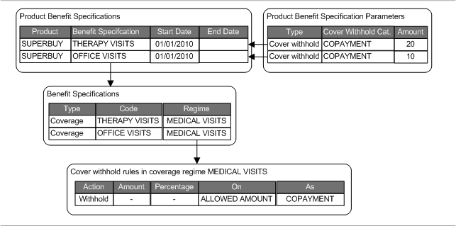

Setting Parameters
Consider the image below. It shows he configuration for a COPAYMENT cover withhold rule using a parameter to set the dollar amount
Both therapy visits and office visits require a COPAYMENT, which is a withhold of a specific amount. The only difference between the two types of visits is that therapy visits require a 20 dollar copayment, while office visits only require a 10 dollar copayment. Rather than setting up two separate coverage regimes, the benefits configuration user chooses to set up a single coverage regime that withholds COPAYMENT without specifying an actual amount.
On the product benefit specification level, the benefits configuration user sets up two parameters: the first to specify that for THERAPY visits, any cover withhold rule that applies COPAYMENT should use an amount of 20; the second to specify that for OFFICE visits, any cover withhold rule that applies the COPAYMENT should use an amount of 10.
